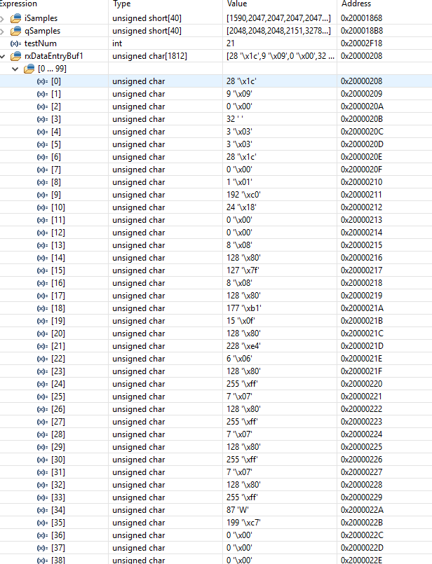

    1. why it would stop when buffer is not full? Acording to you said, it will do contiuous receiving.
    2. I used CoolTerm to receive characters on my desktop. I would like to receive one character array when callback function is called.  However, I could not receive all the data from UART. In most tests I could only receive 4 character arrays("Good!") which I defined above. But when I redebug the code before I excute TROS, it would send the remaining 17 character arrays. Is there something wrong with my UART write function?
    Thank you so much!

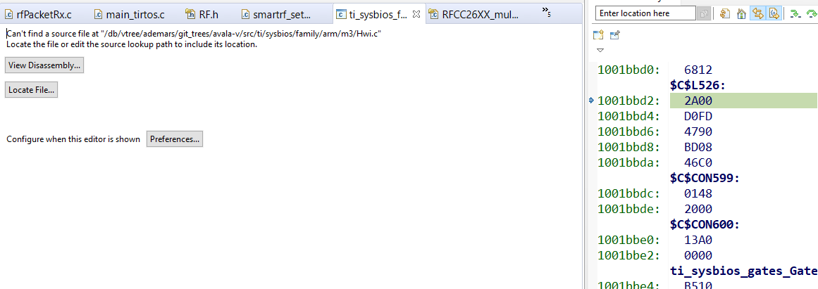

  • I am pretty sure that what you are seeing in the data entry overflowing due to the time it takes to process the UART in your callback.
    I just tested the code from the app note, and did not do anything other that blinking a LED in the callback. It toggled "forever". What you can do is to run your code /with the debugger attached) until your LED stops toggling. You should then "pause" your code and check the status of the RF_cmdPropRx command. It will tell you why RX has stopped.
    Please note that if you "pause" the code from the debugger when the radio is still in RX (LED toggling), RX will be terminated due to overflow. This is because you are only halting the M3 and not the radio core.
    Siri
  • Hello Siri,
    Thank you for your kind reply. I comented all the UART parts but still couldn't get continuous receiving. I have faced the following issues:
    1. I put a breakpoint inside the callback function.(at "if (index == (NUMBER_OF_SAMPLE_PAIRS*NUMBER_OF_BUFFERS))") and I started debug, and the code stops there. "terminationReason" was not found which means, rx is still working. So I just resumed the code. And at the second time it stopped at the breakpoint, it was still undefined. But after I resume, code didn't excute to the breakpoint and I paused it. I saw it stuck in the last "while(1)" in the main thread. "terminationReason" was 2.  I removed the breakpoint and tried manual pausing the code. It had the exact same problem. Rx only terminate after your second pause!  I also tried different excuting time which shows the same results. It seems like it doesn't relate to your excuting time but your pause times. Could you please tell me what would the issue happen?
    2. I add my UART write function in the callback and did the same pasu test. But I didn't see that issue happen and "terminationReason" was not found.
    However, UART was suspended and I got the following issues:
    I check the code and buffer defination, but I didn't find out which part could cause overflow. Could you please tell why it shows I could not find a source file?
    Is there a way to solve these two issues?
    Thank you so much!!
  • You cannot set breakpoints in the code while running RX. When stopping at the breakpoints the M3 (MCU) will be halted but the radio core will be active. It will very fast fill up your buffers. Since the MCU is halted, you are not reading the buffers, so the data entries will overflow and you will exit RX. If you run the code from my app note (do not do any UART processing in the callback, and do not set any breakpoints) you will see that the LED are toggling continuously, meaning that you are in RX all the time. If you want to print you result you must do this after exiting RX. BElow are som ecode I have been used for testing. Please note that the radio stays in RX until a button is pushed. After that 1500 IQ samples pair is printed over the UART. The code will not enter RX again
