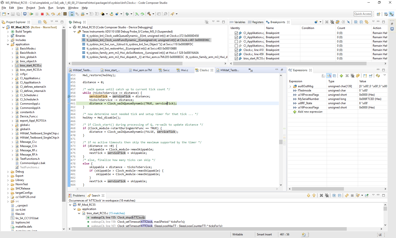

my programm always ends in the TI Rtos function "Clock_walkQueueDynamic" and it does not react on other SWI's. I do not have an idea, why this happens. Does anybody can help?
Some Informarion
CCScreenshot:
Here is also a ROV Screenshot which may help.

  • OK I will look why the screenshot didn't work.
    BR Egon
  • OK. here is (hopefully)
    the CCS Screenshot:
    ROV Info:
  • OK, ones more:
    Ok. Hopefully someone can help me now.
    BR Egon

    what I can say to the swi, th function UInt32 Clock_walkQueueDynamic(Bool service, UInt32 thisTick) is not left by return, the firmware always run into the function. But I do not know which module / swi it is, because I newer come out. I had a look at our board file, but I do not have a module with a swi priority of 5.
    To the clocks, yes period and timeouts are set at other different places on the application. and also starting the clocks.
    Do you know, if it is a SWI of the knl which runs on priority 5?
    BR,
    Egon

  • Hi M-W,
    the "obj->fxn(obj->arg);" is not called. The condition if (obj->active == TRUE) { ...} always stays false.
    What you said about the Void Clock_workFuncDynamic(UArg arg0, UArg arg1) function, I cant follow you, because the firmware dont come back to it.
    Here there is a screenshot of it
    BR,
    Noge

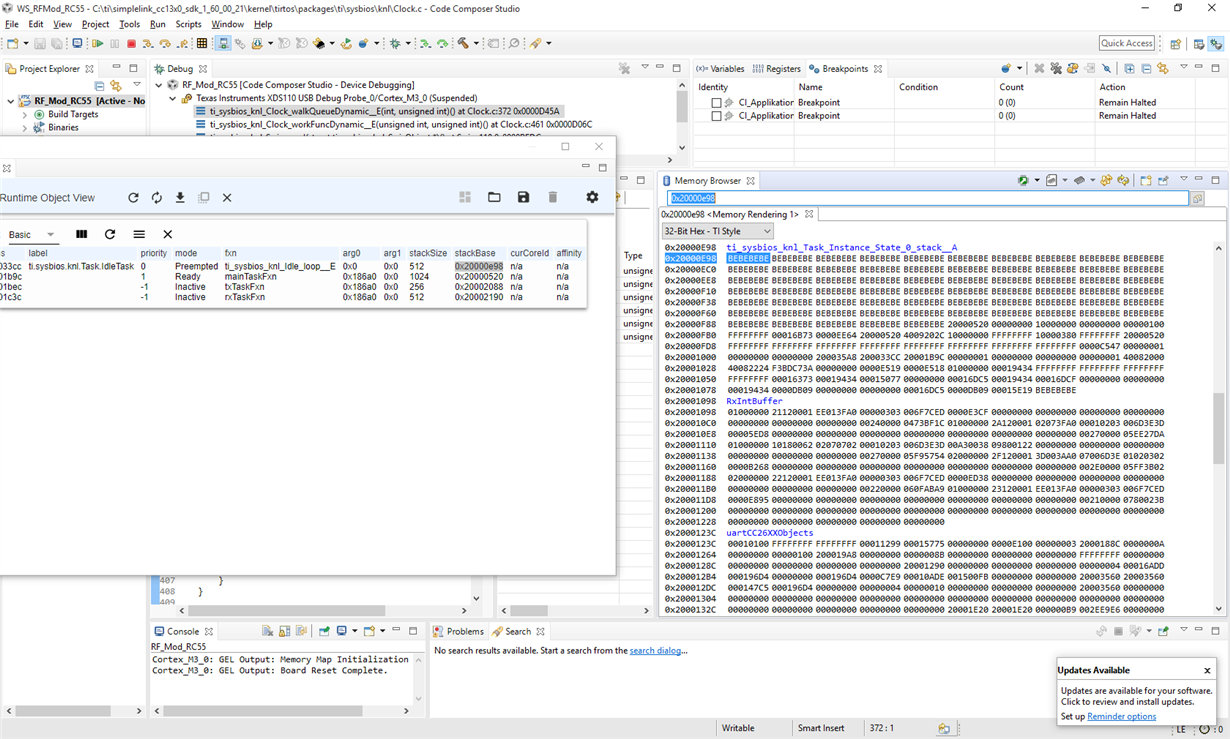

  • Hi Noge,
    I'm not able to directly see what would cause this, could you have a look at the stacks of the system to see if there might be something strange going on here?
    Also, would it be possible for you to share this project (or smaller project re-creating this) with me?
  • Hi M-W,
    Sharing the project will be difficult, because it is confidential information. Part of it may work. But before I will try to have a look at the stack. I used the Stack usage tap of the CCS, but it remaisn empty, Why?
    Her please see my screenshot:
    BR Noge
  • Hi Noge,
    The stack usage guide will not help you in this case. What you can do is to observe the task stacks using the ROV, making sure they have not overflowed. You can also look at the Hwi stack if this still holds.
    Note that the best way to know if the stack is intact is to use the memory address specified in ROV and browse it using the memory viewer. There should be padding bytes in the end of the stack (0xBEBE). If you don't find these paddings, it is likely that the stack has overflowed.
  • Hi M-W,
    See my screenshot:
    What do you think, it seems the stack is empty, but once was filled up to the address 0x20001094. Is the stack mok, or has there been an overflow?
    BR Noge
  • Hi Noge,
    That stack looks fine, you got plenty of padding left. Judging from the tasks, it seems that this occurs early in your program, is this correct?

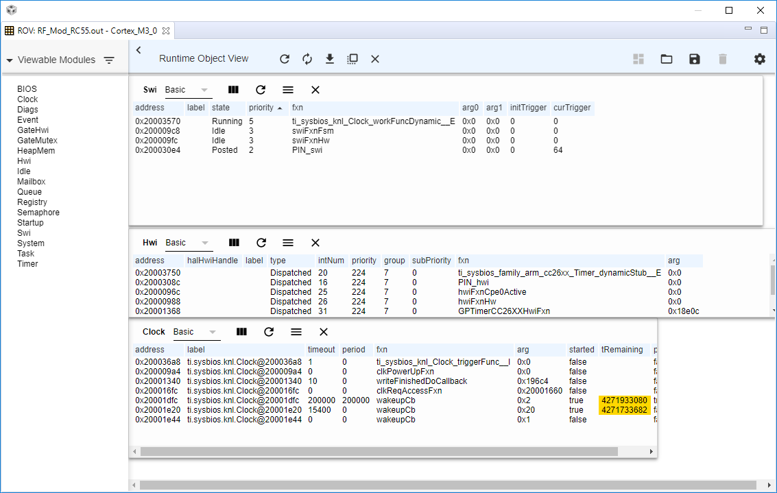

  • Hi M-W,
    I was on a sick leave, so some time passed. But now I'm back on work.  So let' focus on the clock module.
    here you can see the actual ROV:
    Actual I do not know what is messed up in  the clock module.

  • Hi Noge, welcome back.
    Unfortunately, it is very hard to say what could be wrong in your case. If you would be able to share a project that re-produces the issue so that I can debug it, I could possibly help you figuring this out a lot sooner (either here or in private).
    As for the Raw clock view, what is the value of the "Clock module" variables (the once at the top, for example "nextScheduledTick") when you have the hiccup inside the walk function?
    Also, as the callback is rather big, have you made sure that both the System stack and tasks stacks are intact? You can find info on the "System stack" if you look under "Hwi" in ROV and select "Raw" view.
