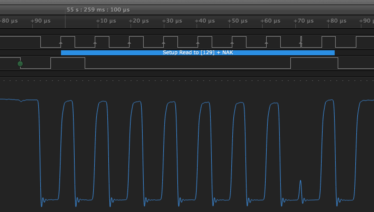

I am working on a custom PCB using PIN_02 and PIN_05 as the I2C lines. I am seeing a glitch on the SCL line after 10-20 minutes when polling once per second (see below).
In software I am getting stuck in I2CTransact(...):
while ((MAP_I2CMasterIntStatusEx(I2C_BASE, false) & (I2C_INT_MASTER | I2C_MRIS_CLKTOUT)) == 0) { }
I have three chips on the slave (HDC1080, OPT3001, and an ADS1015) with a pull-up resistor value of 2.7k Ohms (calculated using the following resource: http://www.ti.com/lit/an/slva689/slva689.pdf)
