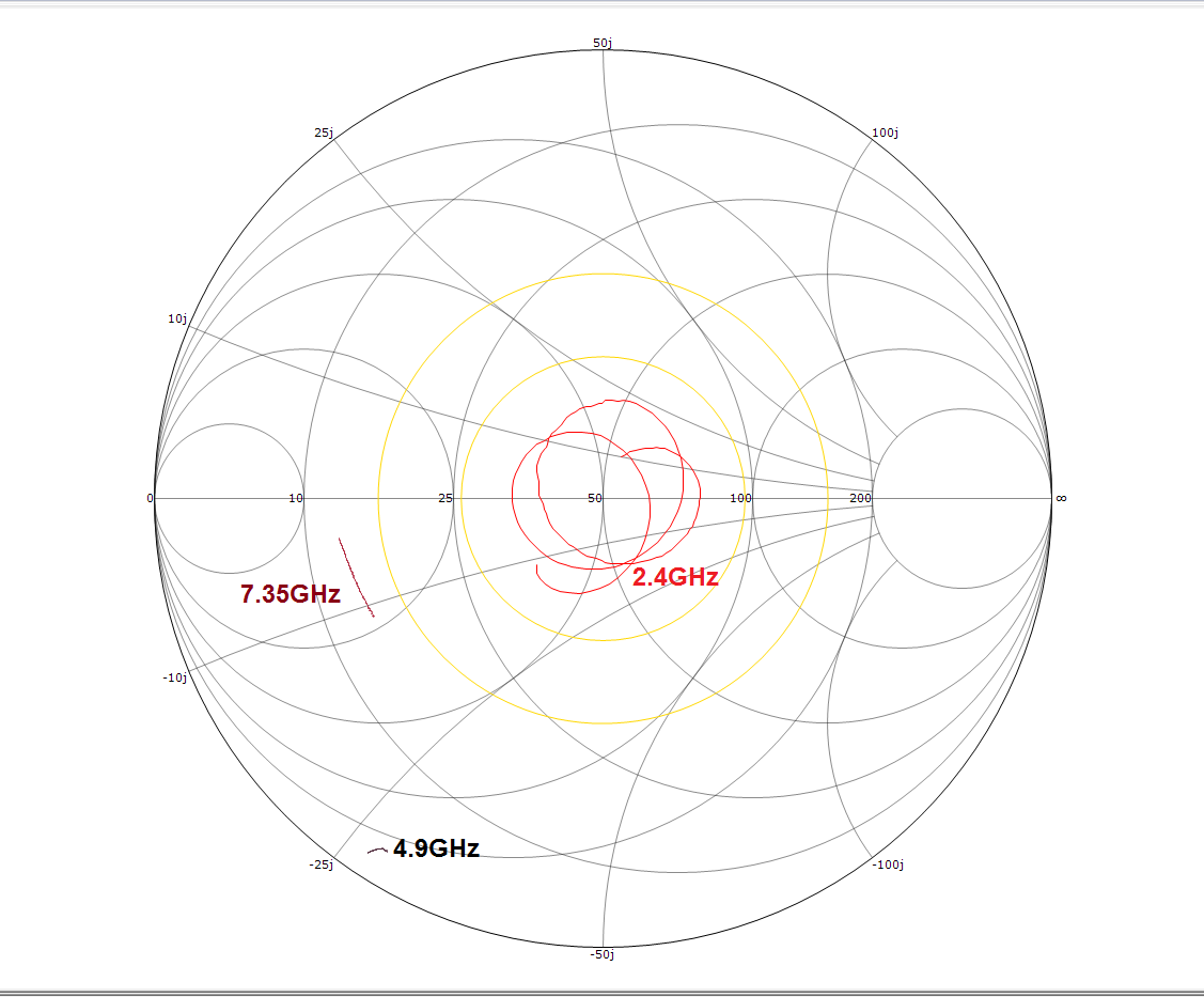

    COuld be that I overlooked something but it looks like you have measured S21 through the filter but not S11/ S22?
    I can share some plots and data files for S11 from the radio side of the filter.
    I went ahead and looked at S11 at 2.45 GHz, as well as the 2nd harmonic 4.9 GHz and 3rd harmonic 7.35 GHz.
    FILT_INPUT_S11.zip
  • I also wanted to add that the VSWR for the 4.9GHz band shown above is over 25. (VSWR for 2.4GHz band is under 1.5). CC2592 datasheet says VSWR under 7.5 is required for stability, but I don't know if this is relevant to the harmonics.

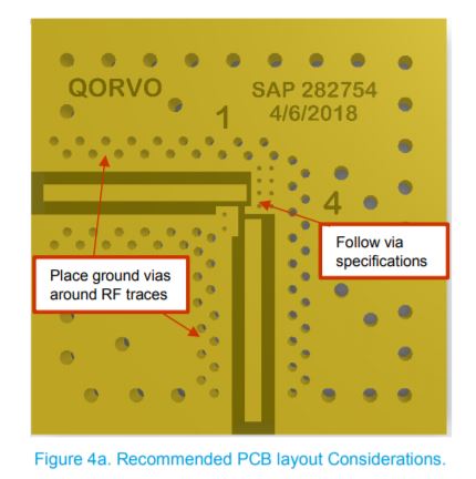

    Have been discussing your case with TER. Can you try the following ?
    In the QPQ1907 app note, Figures 4a & 4b, pin 5 and pin 2 GNDs are deliberately not connected but in your design they are connected together on the top layer. Can you cut the GND between these two pads to see if this helps ? The QPQ1907 recommends not to route underneath the BAW.
    I have checked carefully with Qorvo and the recommended design is indeed to connect ground underneath the filter. That is the way it is (bridged underneath on layer 1) on their eval board gerbers.

    Do you have the gerbers for the Qorvo BAW ref design board ?
    This seems contradictory to Figure 4a. I would still cut the tracks on the top layer between pin 2 & 5, just to test it since this is according to Qorvos app note Figure 4a.
    Richard
    The Gerbers themselves I can't find online, I got them directly in an email so I'm not sure I should post them here. However if you download this datasheet and zoom in on the layout picture on page 3, you can see ground connected underneath on the top layer.

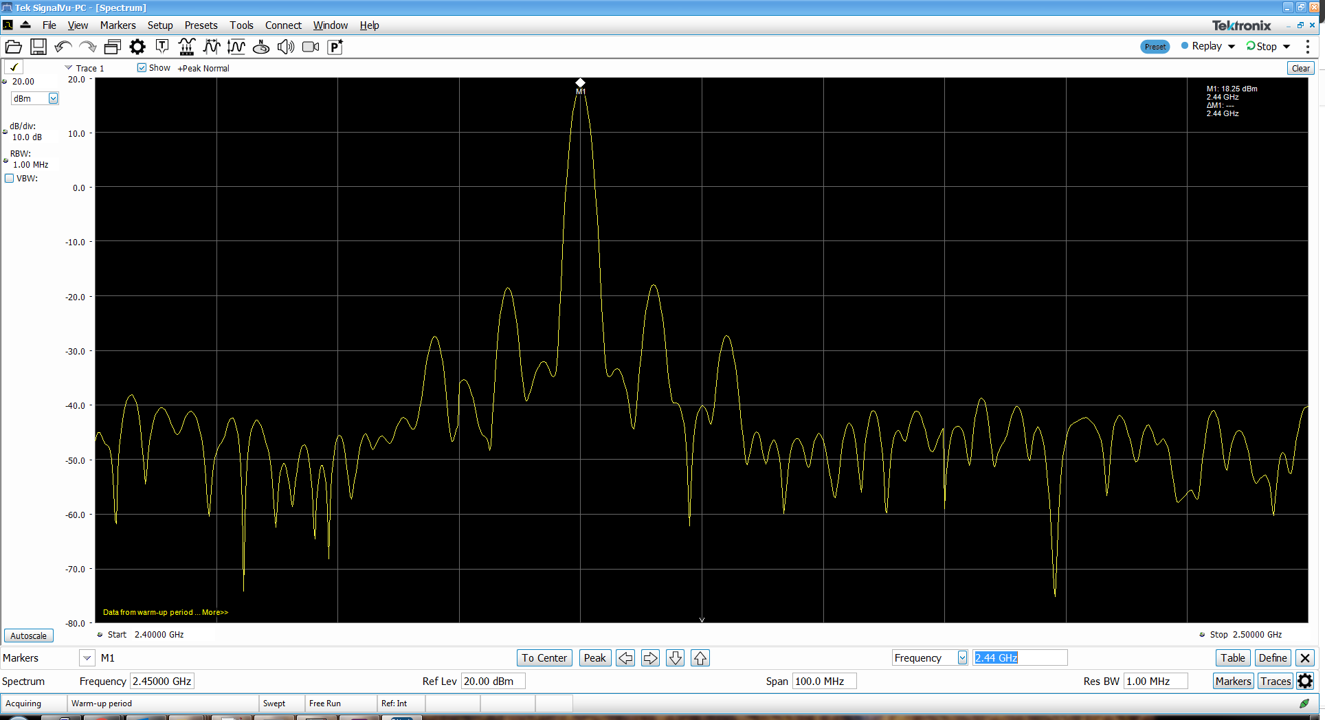

    I made a graph of the output power per channel often going up if I turn down the programmed output power of the CC8520.  I thought you may find this interesting.

    Sorry I thought I posted this plot yesterday but I guess it didn't go through.
    Without the filter on the old board I see sort of the expected behavior when turning power down, see below:
