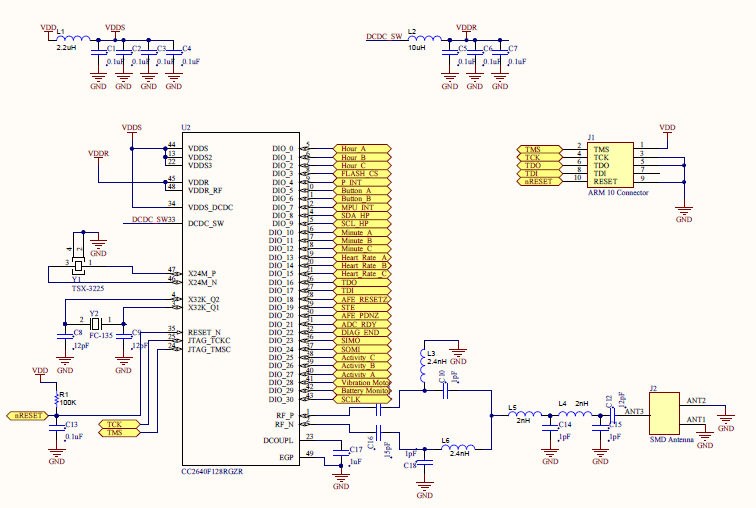

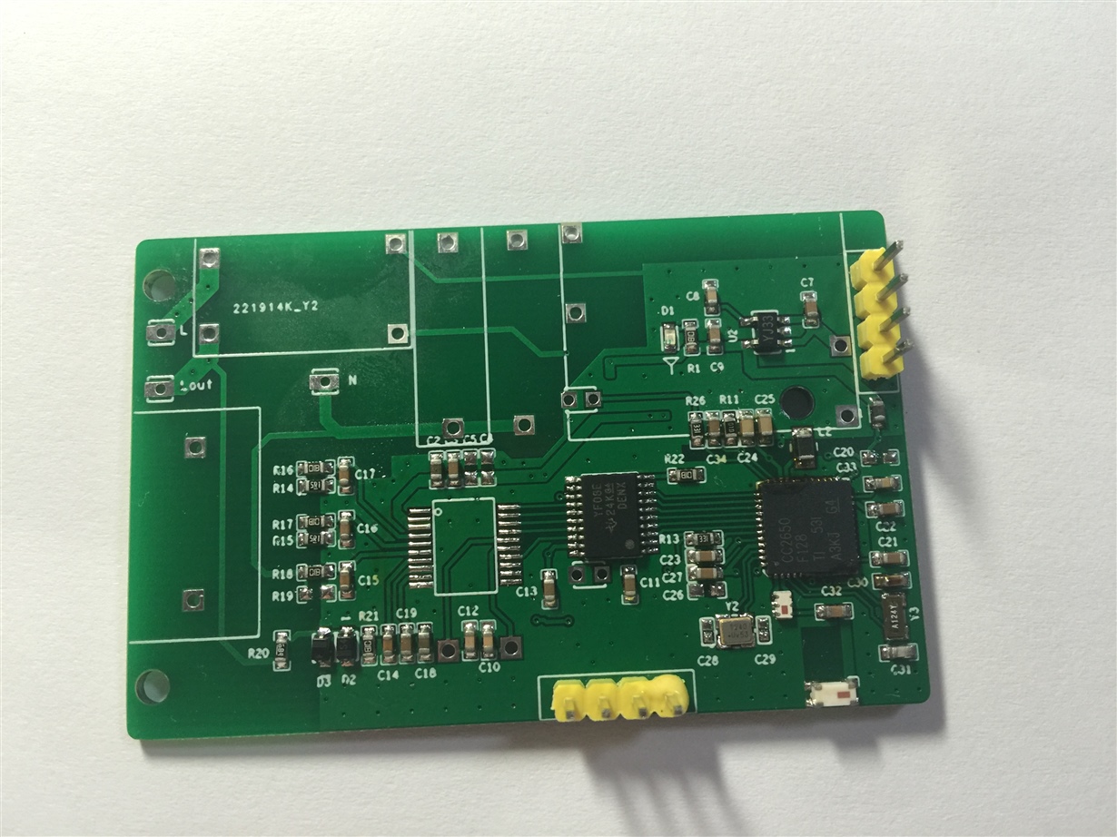

I have a custom made board and I am using CC2650 7x7 chip. I am facing some difficulties in programming the board with sensor tag code for test. The stack file uploads easily without the glitch, but when I try to program the chip with App then error occurs after the code is uploaded. Plz find the error written below.
The problem seems to be a reset loop. Kindly note that the program is easily loaded with Smart RF, and the loading is also verified by a readback.

    Providing a schematic or portions of the schematic will help with this. Also, did you base your board on a TI reference design, if so, which one?
  • Here is the schematic of the board. Its based on Sensor tag schematic. The Power comes from TPS65721 chip providing 3.06V as VDD.
  • The schematic looks fine at first glance. I assume you have verified that the voyage at VDDS and VDDR pins are as expected and stable? What firmware project are you uploading? Are you doing the stack first, then the app as described in the manual?
