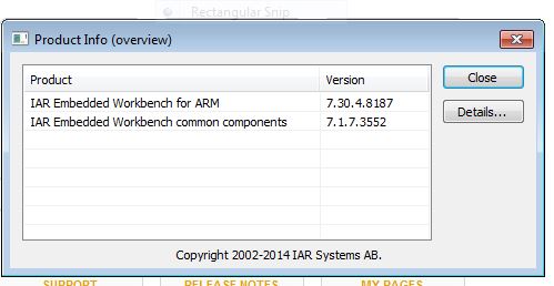

  • Which IAR version do you use?
  • I suggest you to use IAR EWARM 7.40.2 which you can download it from www.iar.com/.../
  • I have installed IAR EWARM 7.40.2 but still it is showing the same error

  • It seems that you install IAR to c:\data\... Which might cause problem. Can you install IAR to default folder?
  • Now I installed it to default folder but still error persists. Following are the messages displaying in error window:

  • Can you take a screenshot of your IAR installation path and ti ble stack?
