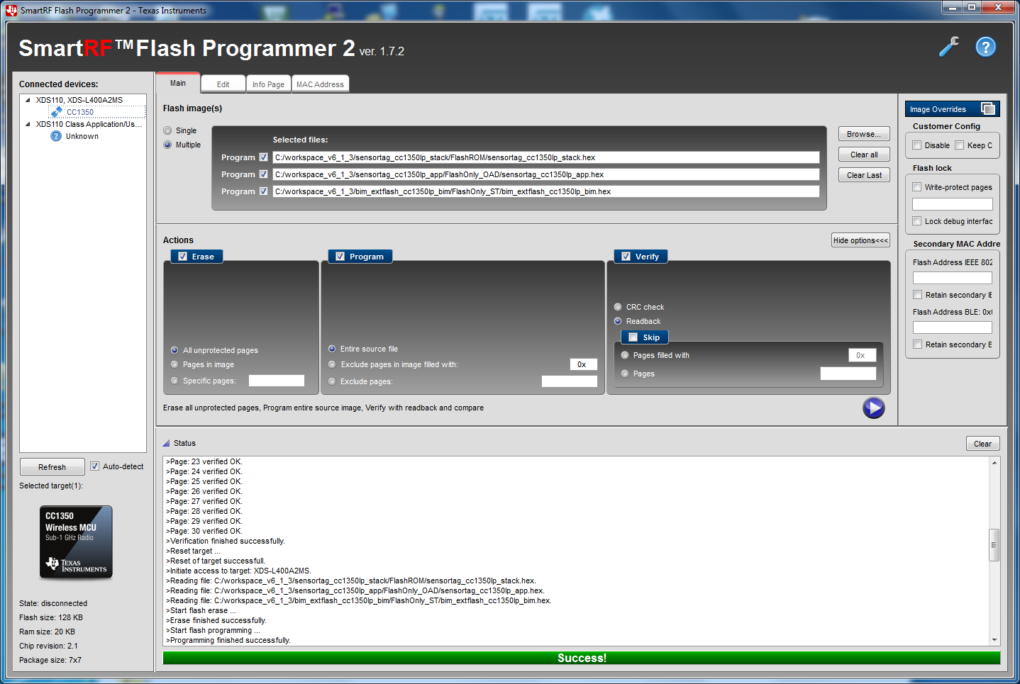

3. If I compile and download sensortag_cc1350lp_app + sensortag_cc1350lp_stack from CCS, it works. But if I download the same apps output .hex files via Smart RF Programmer 2,  CC1350LP BLE Sensortag does not work
(I use these HEX-files:
C:\workspace_v6_1_3\sensortag_cc1350lp_stack\FlashROM\sensortag_cc1350lp_stack.hex
C:\workspace_v6_1_3\sensortag_cc1350lp_app\FlashOnly_OAD\sensortag_cc1350lp_app.hex)

  • Hello Oleg,
    You need to build and program the bim_extflash project/hex as well when using Flash Programmer 2.
    Best wishes
    I downloaded 3 files (see sreenshot below). CC1350Launchpad SensorTAG application started and worked well. But CC1350 SensorTAG firmware upgrade (to Node or Concentrator) still does not work. OAT downloadig process goes smoothly and finished with "Successful Firmware update..." message. But after HW reboot CC1350 Launchpad works in the same SensorTAG mode.
