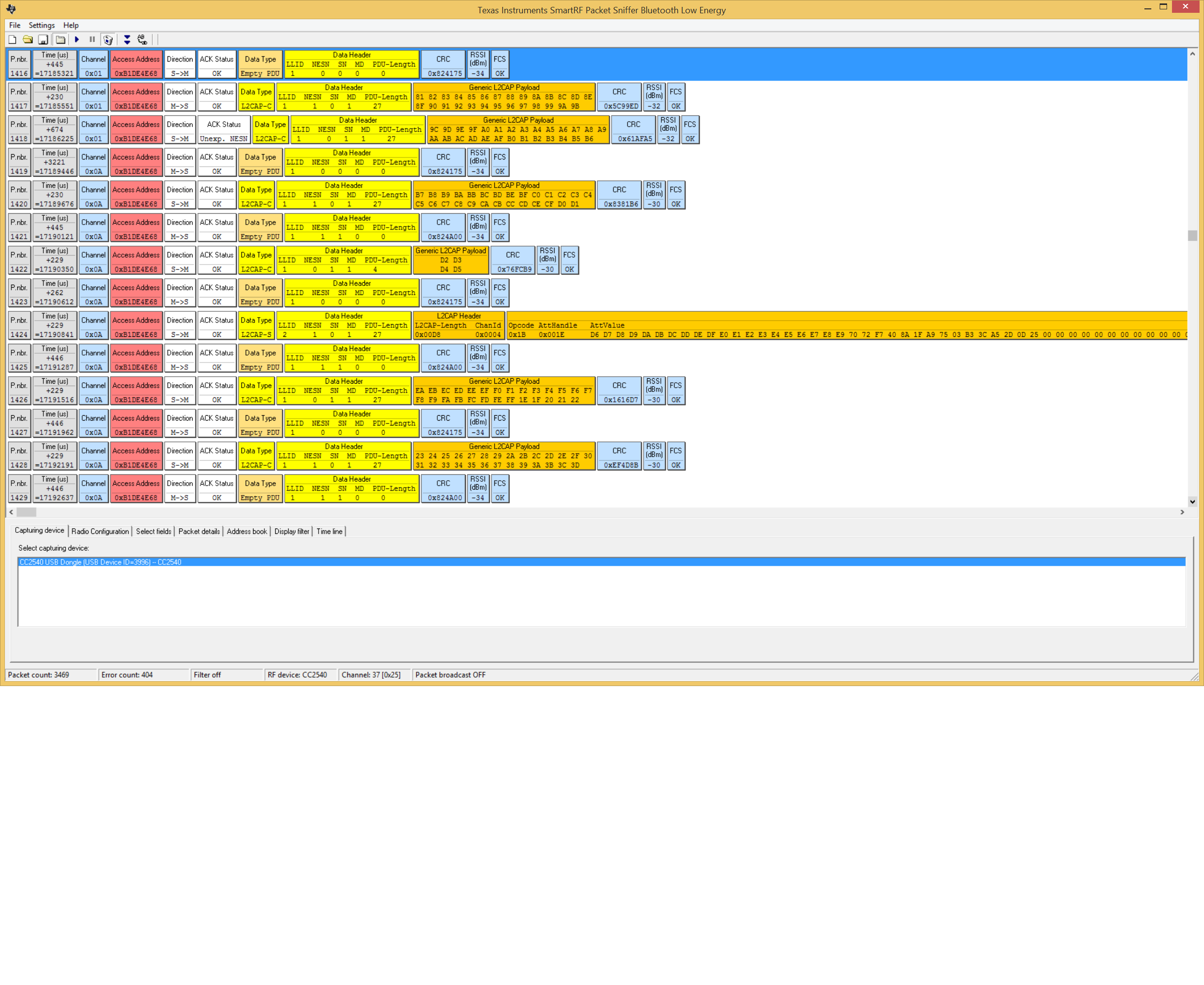

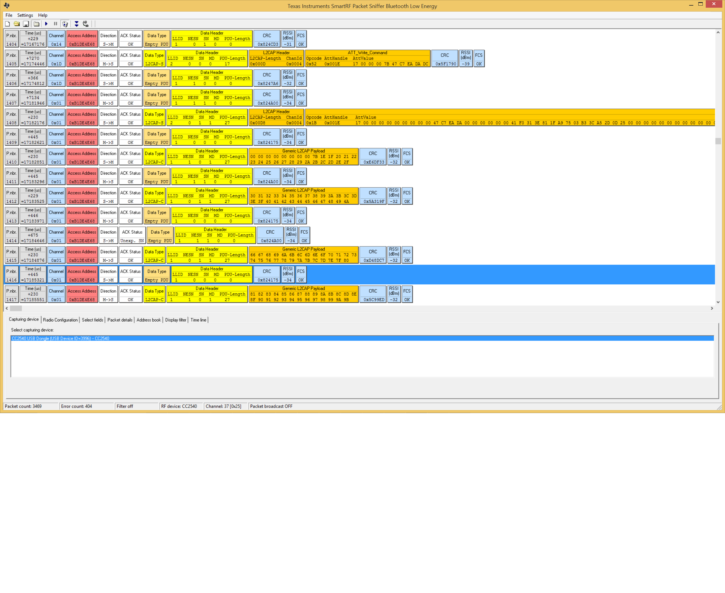

A different test we did was to change the PDU size. For this test we used a CC2540 USB Dongle using SmartRF sniffer
In this setting we are using a connection interval of 7.5 ms and PDU of 27 and the notification is adding enough data to fill 11 PDUs.
We see the PDU going out with a SmartRF sniffer. The following connection interval the peripheral device responds with x PDUs and not the expected 11 PDUs (660us*11 == 7260 us) that should fit within a connection interval of 7.5 ms. Note that after the next anchor point the remaining PDUs is sent. Note that all data is successfully received at central.
What might the reason be that the CC2640R2F choose to send only 7 PDUs and not 11 as the Bluetooth specification suggest should be done?
Here is a SmartRF sniffing session of the ping and response. Notice the long silence at P. nbr. 4722

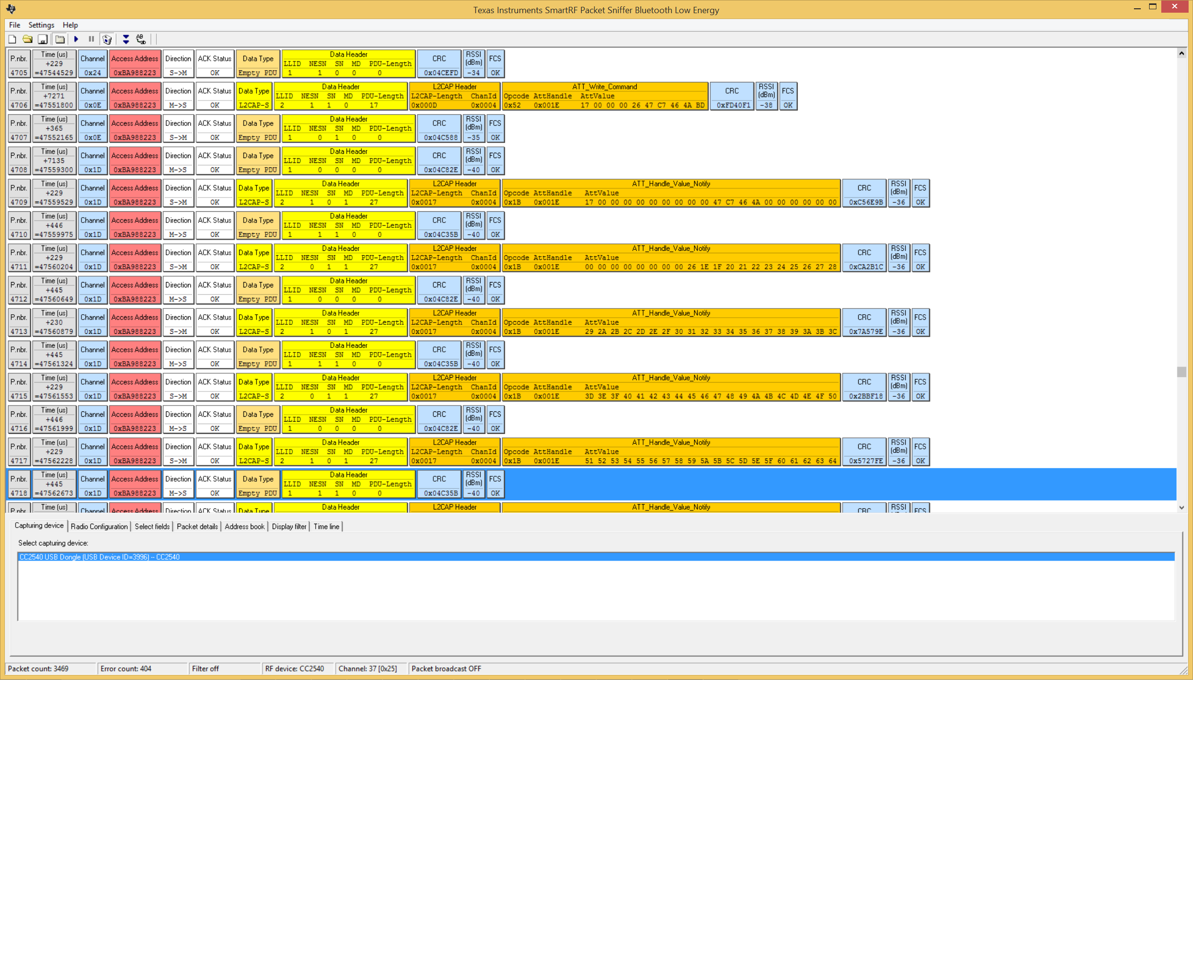

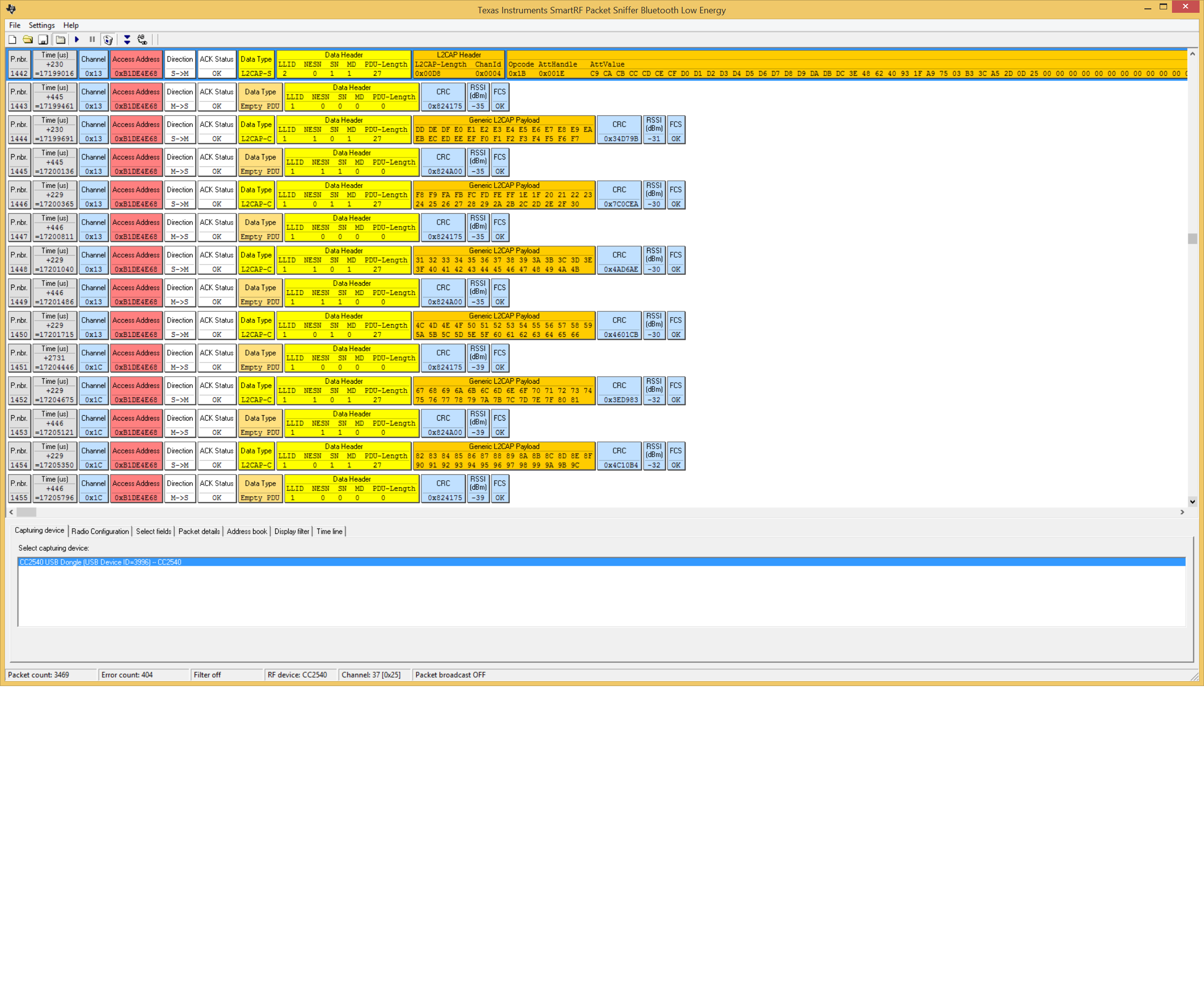

Then we change the PDU to 220:
In this setting we are using a connection interval of 7.5 ms and PDU of 220 and the notification is adding enough data to fill 3 PDUs.
We see the PDU going out with a CC2540 USB Dongle using SmartRF sniffer. The following connection interval the peripheral device responds with 2 PDUs (Size 220) and not the expected 3 PDUs that should fit within a connection interval of 7.5 ms. Following the next anchor point the remaining PDU is sent. Note that all data is successfully received at central.
     What might the reason be that the CC2640R2F seems to send only 1 PDUs in each connection interval and not 3 as the Bluetooth specification suggest should be done? Our time measuring on our PC also confirms that 3 connection intervals is needed for the notification response instead of the expected 1.

    For the throughput example, this timing number is to accommodate for Coded PHY as well, which is 8 times slower. When both a byte and a time value is given in, the minimum of the two are used, bytes and time being corrected in the background for the active phy.
    In your second sniffer picture I can see 4 packets being sent in one connection event. Admittedly the default MAX_NUM_PDU is 5, but the slave needs to keep the last frame it sent for each connection interval because that isn't acked by the master until the first frame of the next connection interval. This is what I mean by slots.
