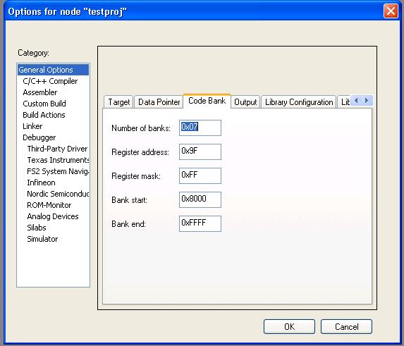

  • Your code bank options have probably been set up incorrectly. For a 256 KB device, they should be set up as follows (reduce the number of banks for smaller devices):
    Note that for IAR v. 7.60 and 8.10, I believe this should be correctly set up by default if you select the right chip as target device:
    edit: Tried once more to get the screenshots to display properly
  • Thanks, that was it.
    My device was generic CC2530, changing it to the specific CC2530F128 that I am using.
    Now the codebank tab is correct (3 banks) and stepping through a banked code call, it's now using a ?BDISPATCH_FF function that does not mess with P1.
