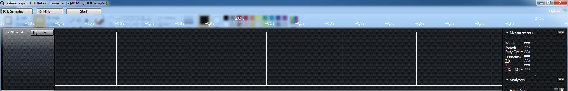

To get started I really just wanna see all bits, noise etc. and hence all package-handling should be de-activated. I've set:
    // Don't use automatic syncword detection
    Cc1125ConfigWrite(0X0009,0x03);  // SYNC_CFG0 set to 3
    // Preamble detection off
    Cc1125ConfigWrite(0X000E,0x00); // PREAMBLE_CFG0 set to 0
Serial RX data "should" be connected to GPIO_0, as the GPIO_0 config is set to 9.
The general setup done for CC1125
- Reset CC1125 with command strobe, CC112X_SRES
- Load all config-values that differs from reset-values
 (those posted above)
- Run calibration according to CC112x / CC1175 Errata note
- Turn on RX using command strobe, CC112X_SRX
I would expect to see a lot of "noise" or random bits with the data directly connected to GPIO_0, but the pni is constantly low. Anyone seeing an obvious problem?

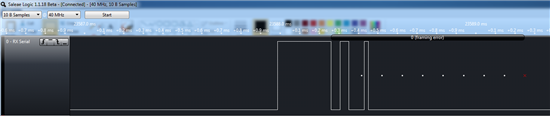

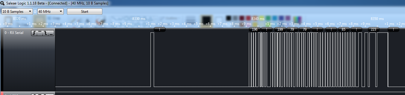

  • I did some more testing today, to find the problem.
    - By increasing the RX filter bandwidth to 200 kHz, I get a constant bit-stream. Not sure why this changes anything.
    - Any lower RX filter bandwidth than 200 kHz gives a ~1 ms output bit-stream, every time i strobe RX (with no carrier present)
    Strobing the RX every ~250 ms. Only the short bit-stream just after the RX stobe is present..
    Zooming in, it looks like only a few bits are shown before flat-lining.
    If a carrier is present whle strobing RX, I'm more or less able to receive a package.
    But for some reason I have to strobe RX pretty much all the time. Is there some AFC going crazy if no carrier is present? Should be possible to go into RX mode and wait for a valid carrier

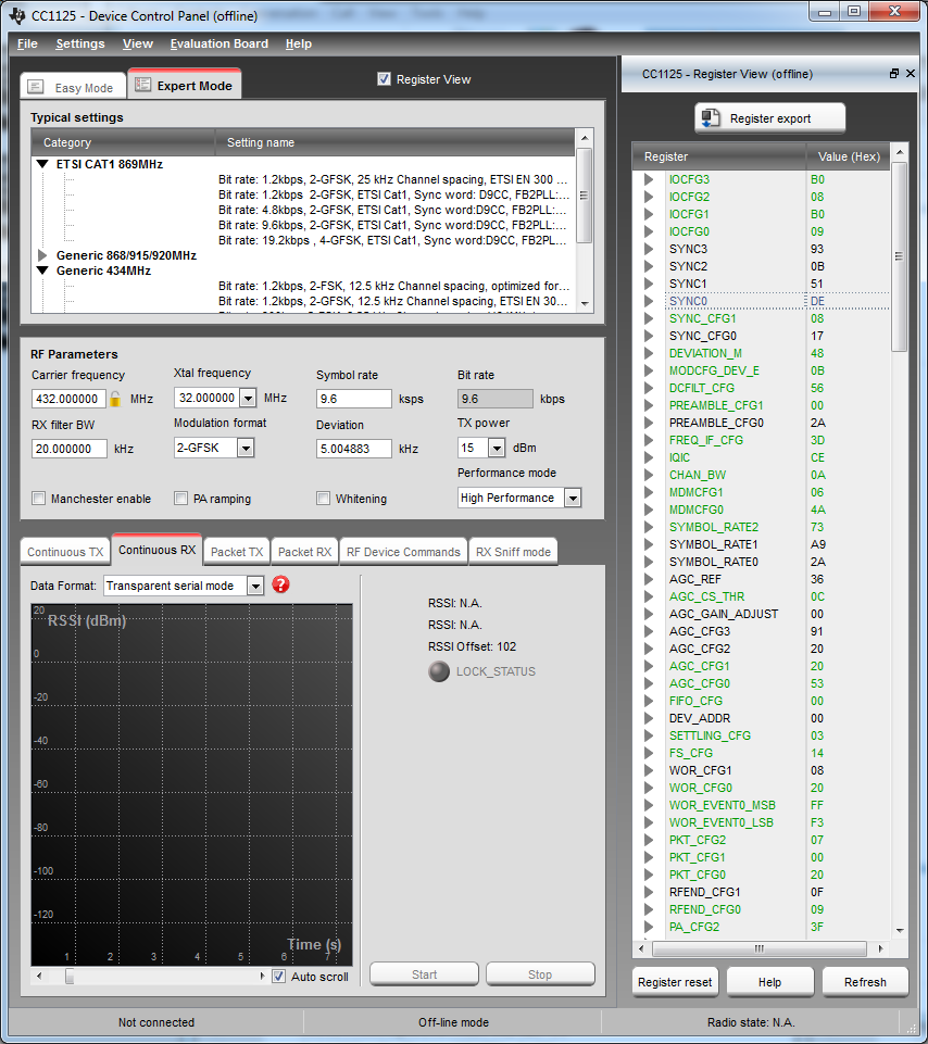

  • Got the problem solved. Choosing another template in SmartRF studio and setting the required settings, resulted in different register-settings, that now works.
    Haven't yet figured out what exact setting caused the problem, but it now behaves as expected.
