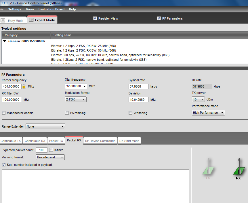

When I  configured the registers of CC1120 and CC1101, the CC1120 still cannot communicate with the chronos watch which uses cc430f6137 mcu.
I configured the frequency, preamble, sync, Rx filter Bw, data rate, packet length, address, frequency deviation, the mode of modulation.
Here are my cofigurations:

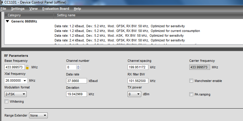

And here is the configurations for cc1101:
// Address config = No address check
// CRC autoflush = false
// Base frequency = 433.999573
// Sync word qualifier mode = 30/32 sync word bits detected
// Manchester enable = false
// Packet length mode = Variable packet length mode. Packet length configured by the first byte after sync word
// Modulation format = 2-FSK
// RX filter BW = 101.562500
// Device address = 0
// Carrier frequency = 433.999573
// Whitening = false
// Packet length = 61
// Data rate = 37.9868
// Preamble count = 4
// PA ramping = false
// Data format = Normal mode
// TX power = 0
// CRC enable = true
// Channel spacing = 199.951172
// Channel number = 0
// Deviation = 19.042969
// Modulated = true
// Rf settings for CC1101
RF_SETTINGS code rfSettings = {

Preamble is 4 bytes 0xAA,0xAA,0xAA,0xAA.      SYNC is 4 bytes 0xD391D391.
Q1:I wonder if I had forgot anything to configure or is there anything which I configured wrong?
Q2: Does CRC need to be configured? Or it is automatically configured?
Q3: I have tried modifying the Tx Power to be the same, but it didn't work. So is thers any need to configure it the same with each other?
Please help.
Can
  • Do you use default sync on CC1120? Note that you have to have the same sync word on CC1120 and CC430 to get it to work.
  • Hi TER,
    Thanks for replying!
    Yes, I used the same sync word which is 4 bytes long. That is 0xD391,0xD391.
    So, I want to know what should I to do?
    Can
  • Is it CC1120 to CC430 or the other way that is the issue?
    Note that the CC1120 AGC settings are not optimal, start with the 38.4 kbps example in SmartRF Studio. Ensure that the CC430 not saturates with a strong signal in.
    Where have you defined the sync word? Why are not those exported together with the other settings?
    I do not know where is the issue is the question.

    - Start with the 38.4 kbps setting for both chips. Change to the wanted modulation (FSK), datarate and deviation. From the settings it looks like you haven't started from the 38.4 kbps settings.
    - Change sync word on CC1120
    - Increase the packet interval to about 200 ms when CC1120 is used as sender. This because the SmartRF Studio interface to CC430 is slow.
    When I did these changes I got a link both ways.
    Thanks for testing the communication!
    I have solved my problem! Whether to start with the 38.4kbps isn't a problem. It only need you set the same parameters!
    Thanks anyway.
