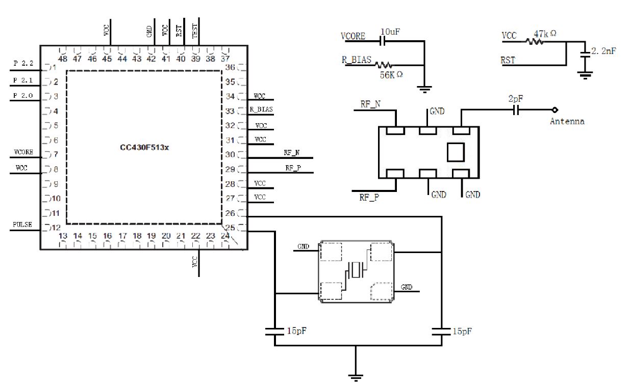

    Because of the project's requirement, I need to soldering my PCB board in a very small size. My CC430F5137 circuit is as below:
It's not good because I had to delete some components from the example circuit (In datasheet). My code can work well on my Launch Pad, but it works bad on my soldering board. The soldering board can sent packet wirelessly but very slow, it  sent packet 2 times per second and it should be more than 100.
I want to know if the circuit is so bad and what is most simple circuit about CC430F5137, I really don't have enough space to put everything as the TI sample on my PCB Board.
  • You should always start from the reference design and not the ones shown in the datasheet. The datasheet drawing shows the concept but not all required components. If you don't have any decoupling of power the performance will be affected.
    That said components and layout will affect RF performance but it should not affect the speed you are able to send packets. How do you measure that it only sends 2 packets a second?
       The  code will go into interrupt after sending a packet, and I set a value "TX", in the interrupt code. Once the chip sent a packet and go into the interrupt, the "TX" will plus one so I can know how many times it sends when I stop running the code.

  • Rui,
    In the diagram you posted earlier there are no decoupling capacitors as required per the reference design, the decoupling capacitors serve a vital function for the device and I cannot predict what happens if they are not present.
