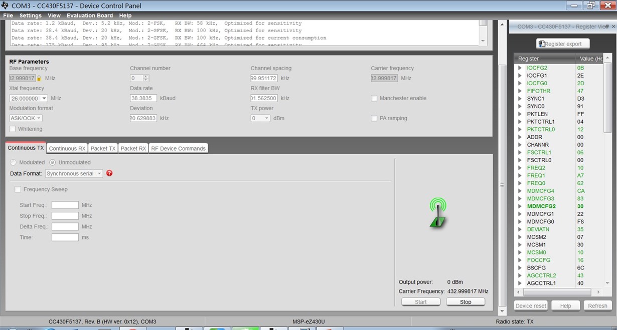

    I used SmartRFStudio to test it. In packet TX, it can send packet. If it means the module can work? But I still can not receive anything. More, when I use power supply to enable the module, the current is nearly 8mA, I check the datasheet of CC1101, it means the packet doesn't run into TX/RX mode.
    This is the result:
    Rui
    Use SmartRFStudio in Expert mode. So, you can have more options. Please see the following figure.

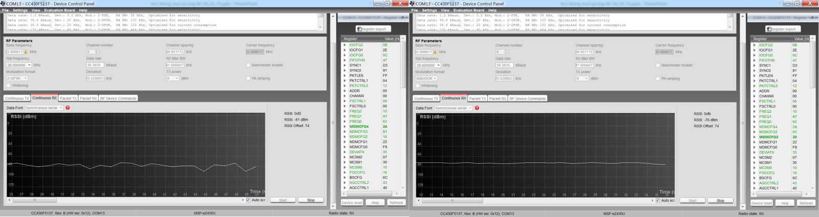

    Thanks for your guidance.
    These are my results:
    I got some RSSI value, if it meant it can work?  But when I changed into Packet TX/RX, I still cannot receive anything in Packet RX.
    Thanks a lot
    Rui
    Yes, it seems working. But I expect more RSSI value when you are using 0dBm on Transmitter and if both Tx and Rx boards are neary-by and equipped with Antennas.
    Why can't I see the "Lock Status" on SmartRFStudio screen shots? It is missing in both Tx and Rx windows.
    Do you have the latest SmartRFStudio version? If not,  please download it again.
    You may try increasing the Rx Filter Bandwidth on the Receiver board to 540KHz. If there is nay offset in Tx and Rx frequencies then this will fix it.
    Are you using 433MHz versions of the board?

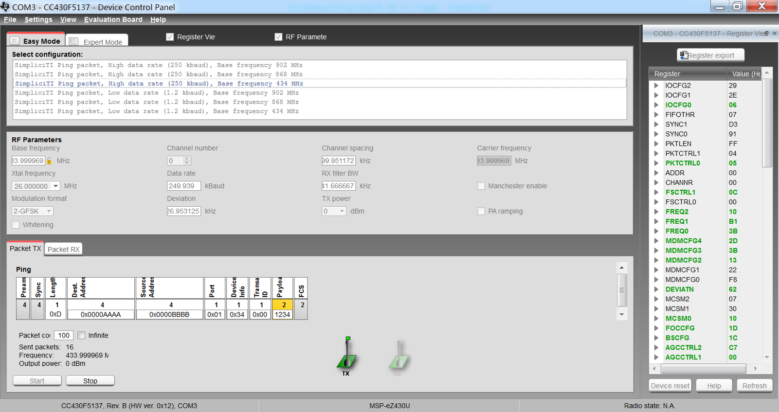

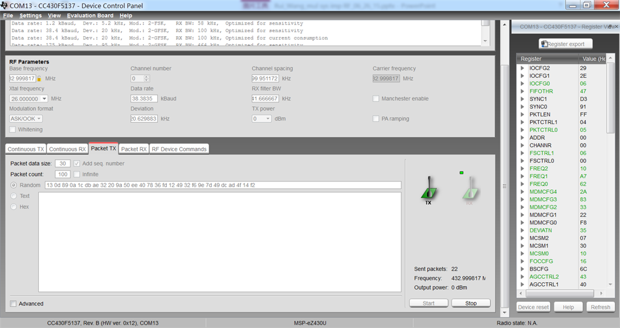

    Could you please post packet transmission and Reception screen shots of SmartRFStudio?
    PM
    I update my version to latest one and try again.
    I still cannot receive anything even I increase the Rx Filter bandwidth in receiver board to 540KHZ and increase TX power on TX board to 10dBm.
    I also change the modulation format to see if something changed, the results are as below:
    And when I turned off the TX, the RSSI didn't change. I think the receiver didn't receive anything. The receiver is a LauchPad, so I think the Tx board didn't work..
    But when I use the TX packet to test the Tx board, it seems can work.
    If I used a good Transmitter board that is a LaunchPad to test, the RSSI value of Rx board is much larger, and it also can receiver data in Packet RX.
    So, I think there are some problems in my Tx board. I design it myself and soldering it on PCBboard, but I don't what's the issues on it.
