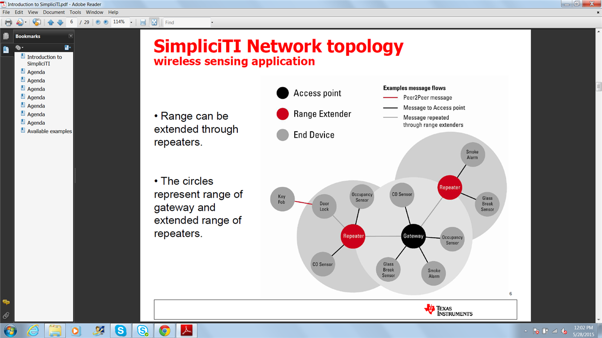

I am working with the examples Folder SRF04.In this folder i am working on AP_as_Data_Hub workspace.
in that i changed the bsp for this EVK CC1110EM 868 and 915MHz.
I tried and i executed and established the communication between ED - AP.i got distance 15 meters.
when i tried and establish communication between ED - RE - AP, it is not sending the data from ED to AP. the ED with in range of AP only it is working, but in out of range using RE it is not working.
if i use RE, i have to get minimum 30 meters distance from ED -AP but i am not getting.
please help on range extender application, how it works, is there any changes need to do in application. please share the details regarding range extender application.
we are trying to build the network as per the TI reference but we are unable to achieve.please find the below reference and please share the details how it works. we have CC1110EM 868 and 915MHz. EVKs, we want to execute with this EVKs.

  • Hi Ravi,
    Have you tried to apply the fix which is mentioned here:
    processors.wiki.ti.com/.../SimpliciTI_FAQ
    could you also check what is the value of MAX_HOPS_FROM_AP in you smpl_nwk_config.dat configuration file? it must be grater than one (just put 2 or 3) to enable RE do the frame forwarding.

    As you can see above, if a node works as RE or AP, it will forward any NWK application frames such as link, join, etc.
    I would suggest to sniff the messages on the air to see whether the ED really sends out the pairing/linking request frames, forwarded by the RE to AP, accepted by the AP, AP sends linking response, forwarded by RE back to ED. I would suggest that you run the sniffing twice, first put the sniffer near the ED to see it sending out link request and also see the RE forwarding the same frame with hop count decremented. Then put the sniffer near the AP to see whether the AP receives the link request and sends out a link response.
