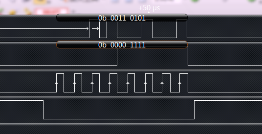

i finish setting the regs and writting TX FIFO  then i write the STX strobe, but i get the status is"0x0f", is it "idle"?  how can i make the cc1200 go into the TX mode?

    The status byte received on the SPI interface when sending the STX strobe will be IDLE as the chip will not exit IDLE before the strobe is sent. If you are sending a SNOP strobe after the TX strobe, what is the status showing you then? What is the MARCSTATE register retuning when reading it?
    Siri
  • thank you very much! i have solved the problem when i set a delay() after the TX strobe, then i get the status of "TX".
