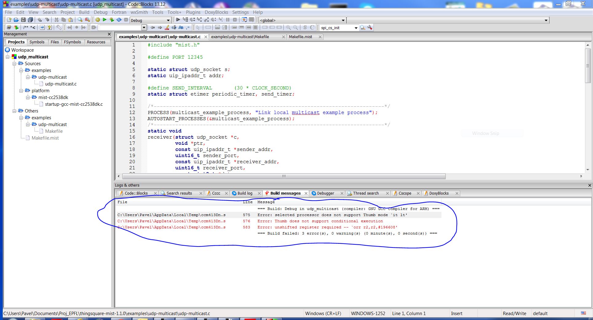

  • Thingsquare doesn't provide project files (e.g. for CCS) so I tried to debug/compile the udp-multicast example with the tool I'm familiar: Code::Blocks.
    I've created the project in Code::Blocks and tried to build it. The result is disapointing - the error message (besides it's incomprehensive) addresses to the some temprorary folder in User\AppData hidden folder (please see the picture).
    Has someone an idea on this issue
    BR
    Pavel
  • Resolved !!!
    Including of the instruction UIP_CONF_IPV6=1 into Makefile resolves the problem.
