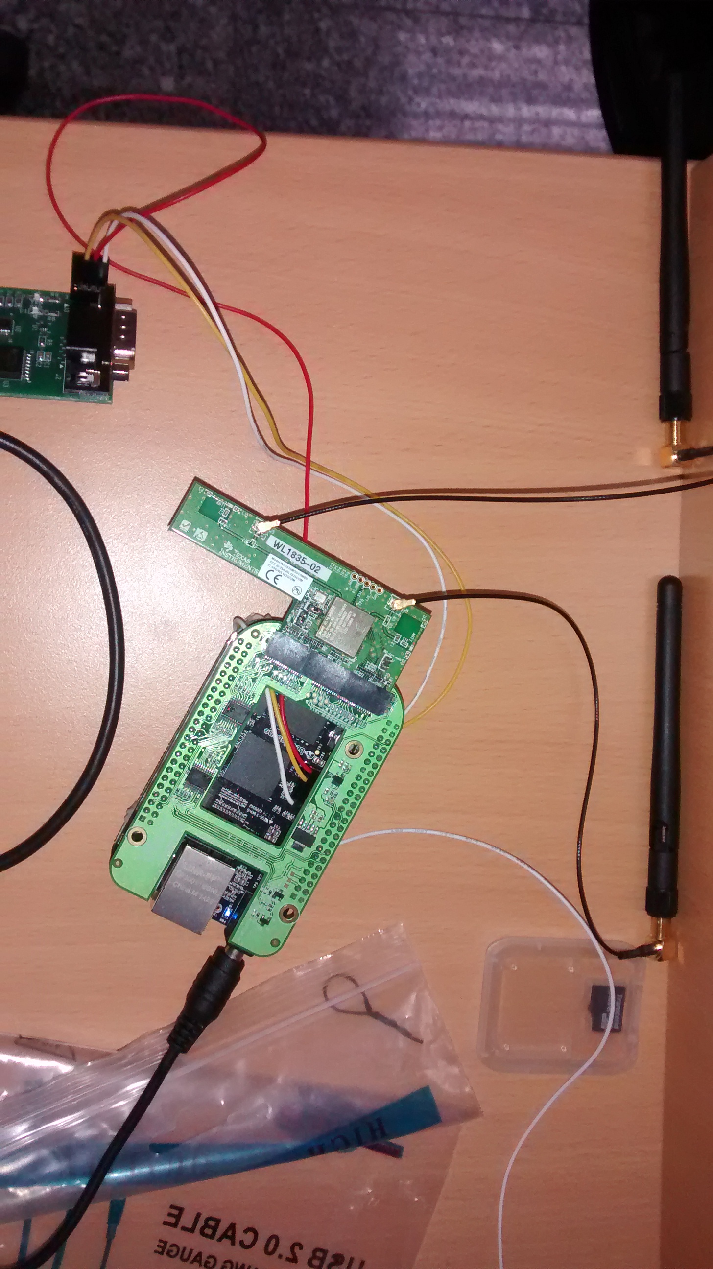

Wl18xx kernel 3.13.7 performance problem
I tried to test with performance of wl18xx and i got that result ( I think its really bad)
1) I connected to an access point.

2) I created a SoftAP with hostapd.conf got in this link : http://processors.wiki.ti.com/index.php/WiLink8_WLAN_Demo:_Linux#AP_.28create_AP_with_no_security.29

In my PC
iperf -c 10.22.22.1 -i 1 -t 30
Client connecting to 10.22.22.1, TCP port 5001
TCP window size: 22.9 KByte (default)
[  3] local 10.22.22.17 port 57534 connected with 10.22.22.1 port 5001
[ ID] Interval       Transfer     Bandwidth
[  3]  0.0- 1.0 sec  2.88 MBytes  24.1 Mbits/sec
[  3]  1.0- 2.0 sec  3.25 MBytes  27.3 Mbits/sec
[  3]  2.0- 3.0 sec  4.00 MBytes  33.6 Mbits/sec
[  3]  3.0- 4.0 sec  4.25 MBytes  35.7 Mbits/sec
[  3]  4.0- 5.0 sec  5.00 MBytes  41.9 Mbits/sec
[  3]  5.0- 6.0 sec  4.38 MBytes  36.7 Mbits/sec
[  3]  6.0- 7.0 sec  3.75 MBytes  31.5 Mbits/sec
[  3]  7.0- 8.0 sec  4.25 MBytes  35.7 Mbits/sec
I dont know why it just run 8 times, and i couldn't ping host
ping 10.22.22.1
PING 10.22.22.1 (10.22.22.1) 56(84) bytes of data.
From 10.22.22.17 icmp_seq=1 Destination Host Unreachable
From 10.22.22.17 icmp_seq=2 Destination Host Unreachable
From 10.22.22.17 icmp_seq=3 Destination Host Unreachable
From 10.22.22.17 icmp_seq=4 Destination Host Unreachable
But in device I did not see packet lost

and when i tried to kill hostapd and run it again i got that dump:
^CWaiting for server threads to complete. Interrupt again to force quit.
^Croot@OpenWrt:/#
root@OpenWrt:/#
root@OpenWrt:/# hostapd hostapd.conf &
root@OpenWrt:/# Configuration file: hostapd.conf
nl80211: Could not configure driver mode
[  129.306532] wlcore: WARNING Unable to flush all TX buffers, timed out (timeout 500 ms
[  129.816531] wlcore: WARNING Unable to flush all TX buffers, timed out (timeout 500 ms
[  130.326544] wlcore: WARNING Unable to flush all TX buffers, timed out (timeout 500 ms
nl80211 driver initialization failed.
hostapd_free_hapd_data: Interface wlan1 wasn't started
[  133.776527] wlcore: ERROR Tx stuck (in FW) for 5000 ms. Starting recovery

  • Hi Joseph,
    Here is my antenna
    Tuan Nguyen
  • Hi Tuan,
    That looks okay too... Do you get this low TP only during multirole? What are the iPerf numbers during single role (STA or AP)? Can you share the exact commands that you are executing?
    For AP, it would help if you set: ieee80211n=1 in the hostapd.conf file.
    Gigi Joseph.
