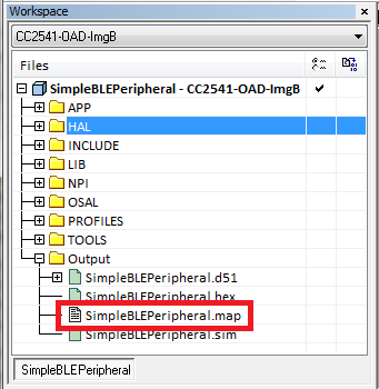

    In the IAR Workspace, you have a folder called Output. If you compile the project, it should include a file with .map extension. This map file includes a section called "Module Summary" which will show you what different parts of the code consumes in flash/RAM. At the end of this file, you will see the summary.

    I didn't find any 'Output' named directory in my IAR workspace for my project. I can see 'OAD-ImgB', 'Release' and 'settings' directories, that generates run time after compilation. And there are two .map files, one at <project workspace>\Release\List\*.map and other at <project workspace>\OAD-ImgB\List\*.map. And there is nothing called 'Module Summary' in any of the file.

    I was referring to the workspace within IAR;
    That should be the same file you found in Release folder though. What does it say in the bottom? Could you share the file here?

    Thanks for your reply. I misunderstood regarding the .map file location. Now I got it!
    I found following on the bottom of that file:
