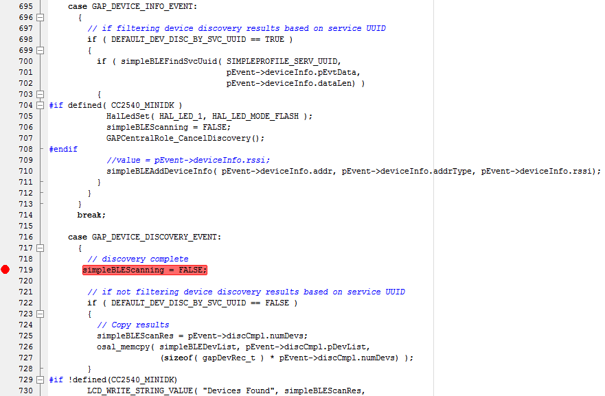

Cannot set a breakpoint in a given method in SimpleBLECentral.
I have spend hours figuring out why I can't set a breakpoint anywhere in GAP_DEVICE_INFO_EVENT case.  The breakpoints suddenly jumps down to
GAP_DEVICE_DISCOVERY_EVENT, whenever I'm starting the debugger. What is the reason behind this ?.

  • I have tried, and the only difference is that I can now set a breakpoint at the "break" in line 714, but cannot still set it anywhere in GAP_DEVICE_INFO_EVENT . It just bothers me that it is the only part of the whole project, where I'm not able to debug.

  • I found the issue. I tested it once again by downloading the source code without any modifications, and it works well.
    The issue occurs once I'm adding the rssi parameter in simpleBLEAddDeviceInfo:
        static void simpleBLEAddDeviceInfo( uint8 *pAddr, uint8 addrType, int8 rssi);
    and parsing the three parameters in GAP_DEVICE_INFO_EVENT
        simpleBLEAddDeviceInfo( pEvent->deviceInfo.addr, pEvent->deviceInfo.addrType, pEvent->deviceInfo.rssi );
    Is there any explanations of why it fails ?.
