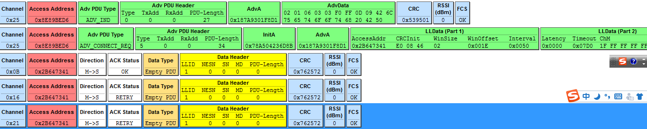

CC2541 Can't connect
Other Parts Discussed in Thread: BLE-STACK, CC2541DK-MINI

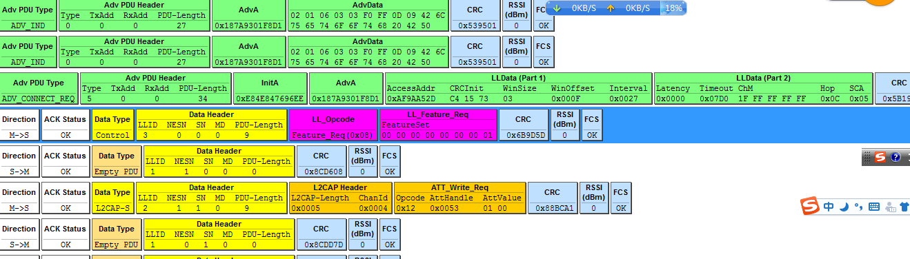

I use SimpleBLECentral demo, but can't connect SimpleBLEPeripheral.  But when i use  download APP from network,  the sniffer data as below, can someone tell me what  is wrong?
right data:
fail data:
    Although the sniffer trace is helpful, can you list the SW version(s) of the BLE-Stack for both devices and whether this test was performed with both devices running on a TI HW reference kit (e.g., CC2541DK-MINI keyfob).
