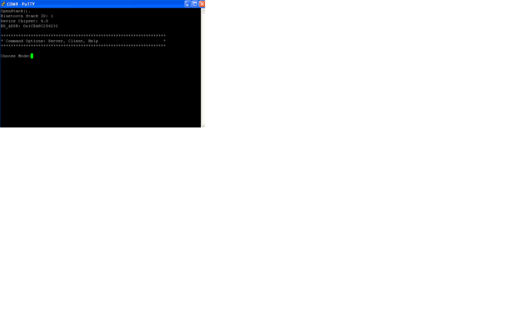

The log for a working demo :

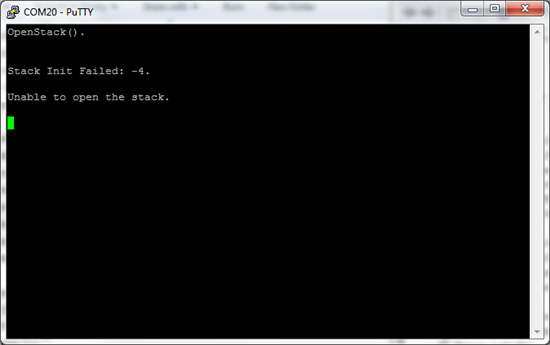

For a non working demo :
I use the same configuration for both. I just used a picture I found on the net for the non working demo log, this is why it is windows seven for only one picture. I have exactly the same message : "Stack init failed..."

Stack Initialization on Port 1 115200 (UART) Failed: -4.
Unable to open the stack.
