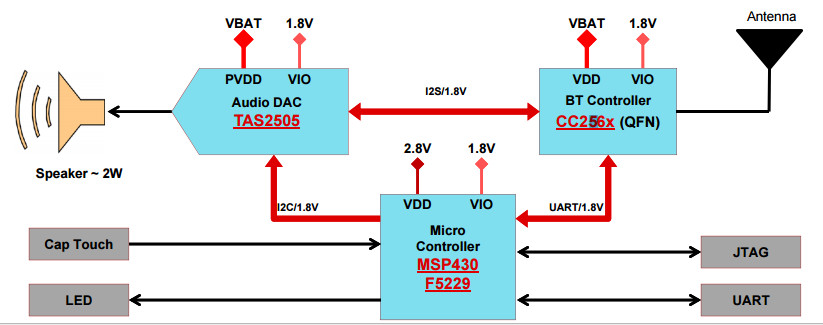

My question is related to the Stonestreet One Bluetooth stack.
1) What firmware is running on this board as factory? It seems as though the A3DP demo profile needs 148kb of memory, which is more than what the MSP430F5229 can handle...
2) Is the answer to 1) the reason why this board will only handle low quality audio? I'd like to utilize the same design with a different MSP430 chip (MSP430F5438) to allow high quality audio (44kHZ, 16 bit). Will I run into issues?
3) If using a digital input speaker amplifier (like a TAS2505), is it better to send the PCM data to the amplifier from the CC2564 or from the MSP430? Does it matter? I'd prefer to do it from the CC2564...
Thanks!
Daniel

    If you are using CC2564B you can route the Audio data from the CC2564B.
    see http://processors.wiki.ti.com/index.php/CC256x_Audio_Sink_User_Guide

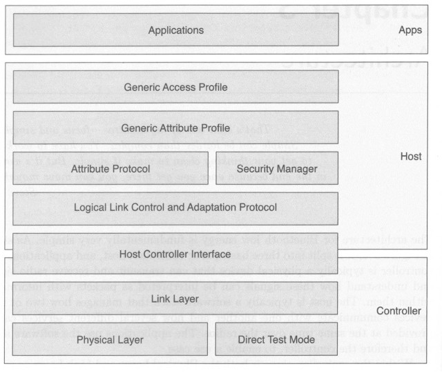

  • Charles Gervasi said:
    Does this mean the upper levels of the stack run on a separate MCU.  Everything HCI and below runs on CC256x?  Are the there images available for both of them?
    I've been looking at this further, and I think the CC256x runs the HCI and everything below it on the stack.  The MSP430 runs the user's application.  So in this case there is an image available for CC256x that you can use with no software to maintain.  The developer writes the code for the MSP430 and includes the higher level of the stack in the code.  You can test which commands to send to the HCI, which runs on the CC256x, by configuring the MSP430 as a USB-to-serial bridge.  Are there software tools from TI to handle to higher layers of the stack?
    The CC256x runs the HCI Controller and everything down. The MSP430 runs the HCI Host and everything up. The TI Bluetooth stack exposes APIs for the applications to use. The stack and application runs on the MSP430. There are a number of sample applications provided to get familiarised with the APIs. The stack during it's init will also ensure that the firmware to CC256x is downloaded.
    The best place to start would be processors.wiki.ti.com/.../CC256x where there are a number of articles.
