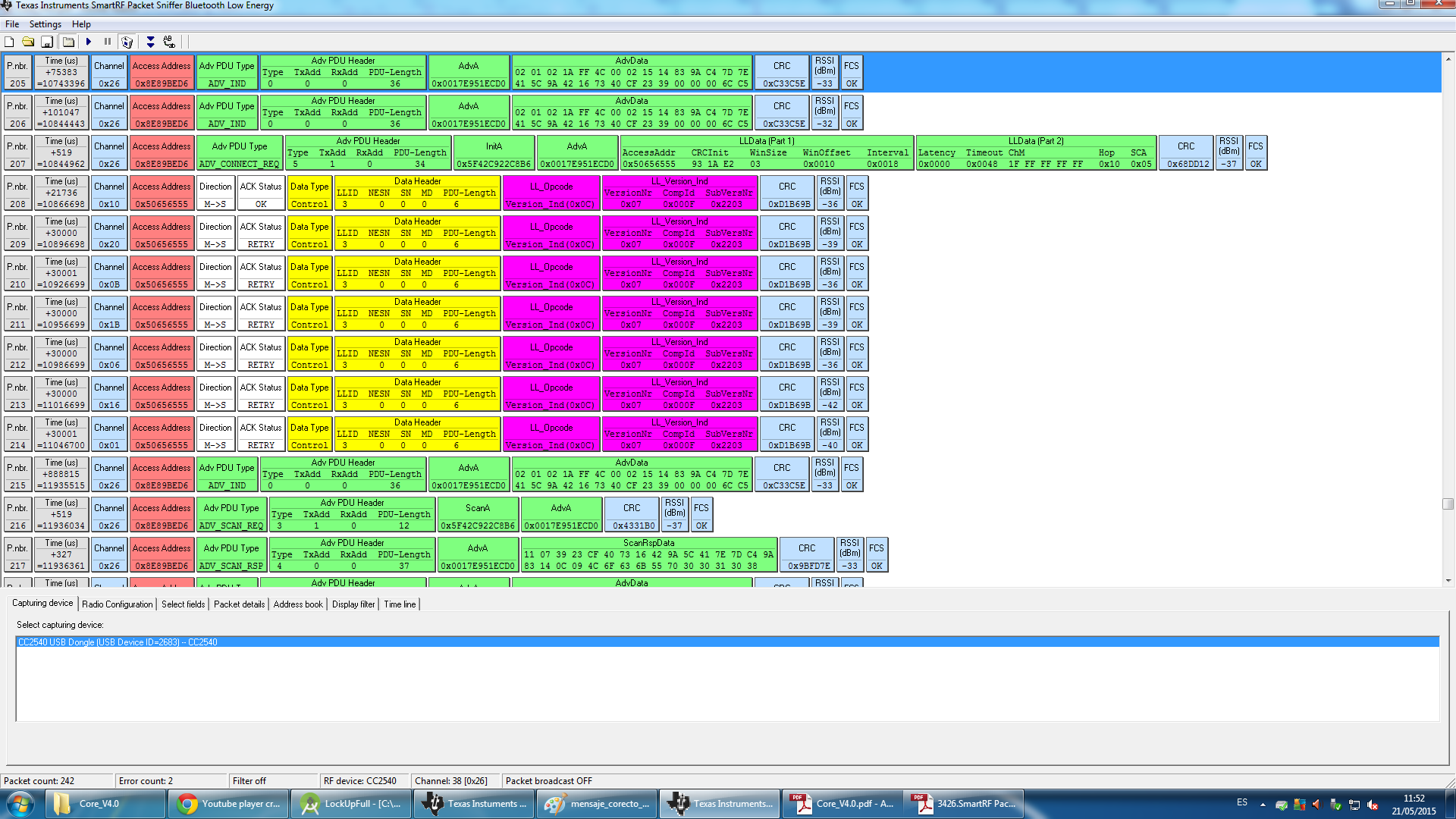

We are developing an application where an iPhone should connect to an cc2564 device (Specifically cc2564+msp430f5438), the application should make quick and short connections to send some data. We need reliability in the connection so we need to know if the connection was really successfully or not, and we need a way to connect to the device with assurance.
The iPhone connects correctly to de device most times, it discovers services and works as expected, but sometimes the iphone makes the connection but the callback of discovered services is never called.
We used a sniffer to look at the communication packages and we saw that in those cases the connection package was send but there wasn't any response from the device, the phone tries to retry some version request messages and then stops, as you can see in the image:
The problem seems to be on the device, we are using the SPPLEDemo sample provided by Texas, and the first function that is called when the connection is established is GAP_LE_Evenet_Callback, and when  the problem occurs it's never called. We don't know if somewhere inside the GAP API the device receive the connection message.
Is there some way to debug it or to know if the connection message is received by the device when the error occurs?
Is it a problem on the iPhone (unlikely), or is a problem on the device?
