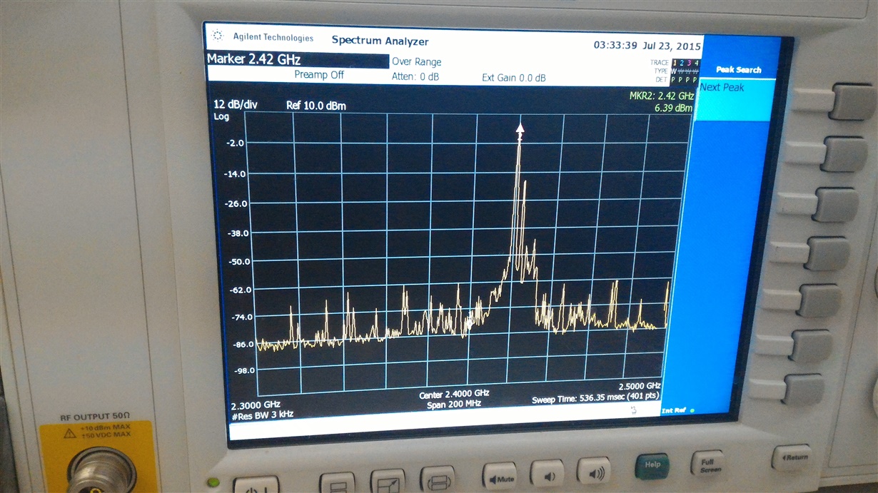

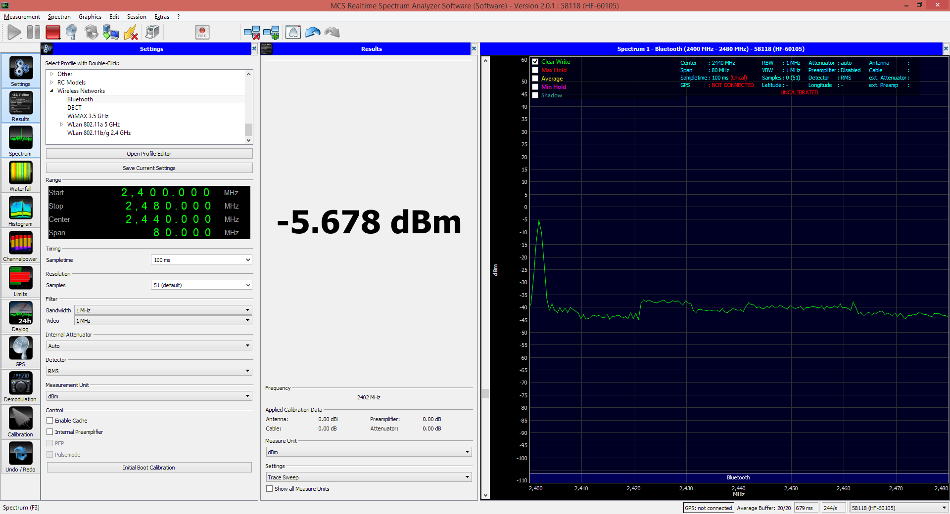

I'm doing RF tests on the CC2564B on my board.
Using the HCITester, I want to show continuous transmission of BLE.
After sending the con_tx command, the transmits, but does not respond to further commands. It must be power-cycled. The results from the spectrum analyzer don't look like a smooth GFSK signal:
What I've done is loading the SP initscripts_TIInit_6.7.16_bt_spec_4.1.bts, then initscripts_TIInit_6.7.16_ble_add-on.bts. Then the Con_Tx command:
Send_HCI_VS_DRPb_Tester_Con_TX 0xFD84, 0x4, 0x2, 9, 1, 0x00000000, 0x00000000
Wait_HCI_Command_Complete_VS_DRPb_Tester_Con_TX_Event 5000, any, HCI_VS_DRPb_Tester_Con_TX, 0x00
Note that when I select other modulations CW/GFSK/2-EDR/3-EDR, the device is functioning.
What causes the device to stop reacting?
I'm attaching a log from the HCITester, if that helps.cc2564b ble stuck2.htm
