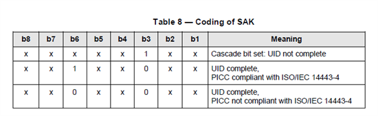

  • Harry -
    you have a double size UID (seven bytes) here of: 041BB75A5D2B80
    in the first pass, the 88 indicates at least double size UID is present, the 0x20 is the BCC (XOR of the four preceding bytes)  then the second pass yields the rest of the UID 5A5D2B plus its BCC of those four preceding bytes, which is 0x80.
    what is the SAK response of this tag you are using?

  • Hi Josh,
    Thanks for the pdf file.
    The SAK response should be 0x08 according to the Mifare classic tags I am using.
    And I see the SAK response to Select command to be 0x08 when I use 4 byte UID tags.

    14443A Select.
    (4400)(04)[00]
    This means that the SAK response is 0x04 for 7 byte UID tags that I use, right?

  • Hi J.D.
    Sorry for not recognizing that you responded to my question earlier.  I just assumed that it was Josh.
    I already have the same zip file you have posted.  And I am aware of those code that you have mentioned.
    I suspect that the reason for authentication failure is with SAK return for 7 byte UID tags when executing  selectCommand.
    For 4 or 7 byte UID tags, SAK is supposed to be 08.   However, only with 7 byte UID tags, SAK becomes 00.
    select command is executed with 0x93 (CL1), and then with 0x95 (CL2).  the UID (first 5 bytes of the UID for the first select command and then the second 5 bytes of the UID because there are extra 3 bytes, first byte for the double size UID and 2 BCC bytes).
    With the first select command, SAK is 04 and with the second select command, SAK is 00.
    Is SAK supposed to be 08 when executing the second select command with 0x95?

  • Hey Harry,
     The SAK shouldn't be the problem.  Both 0x00 and 0x80 are acceptable responses and will depend on the tag used.  Below is the SAK bit coding from the ISO14443 Spec.

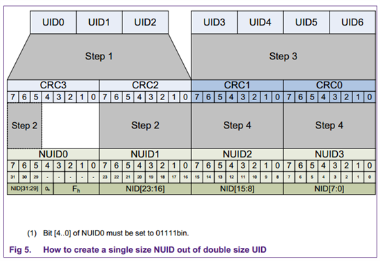

    JD
  • Hey Harry,
    So I found out this code isn't going to work in it's current state with 7 Byte UID's.  Page 11 of this document explains the steps needed to be followed in order to have full functionality with the 7 Byte UID.  Below is a the figure explaining the steps.
    Basically, with the 4 Byte UID, we can just feed the 32 bits into the Authentication.  Now, we need to create the 32 bit NID by using a CRC functionality of the 7 Byte UID (with 1 buffer byte), then feed in this NID.
