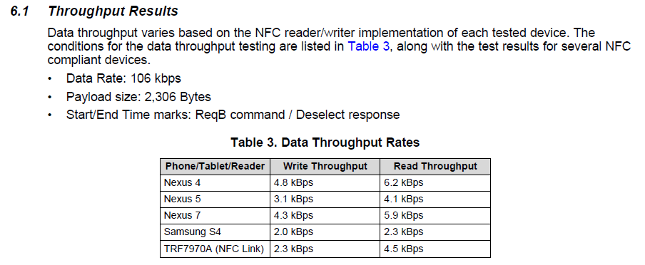

Hi community member,
Would you please provide the throughput data of RF430CL330HTB such as below?
Note: I refered this URL: http://www.ti.com/lit/ug/tidu378a/tidu378a.pdf
Best regards.
Kaka
Hi Kaka,
The throughput would apply to the chip and not the board, so you would see the same throughput with the either board.
