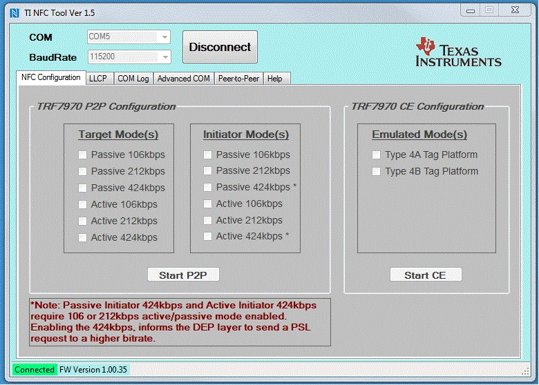

  • Hi John,
    I uploaded the MSP430F5529_P2P_Demo.hex file with MSP430 Flasher and it all seemed to go well. I started up 'TI NFC Tool' software, choose the com port (MSP430 Application UART1, visible in my Device Manager), pressed Connect and on the left bottom of the screen the text changes to 'Connected' and turned green.
    The problem is that I don't get a software version (sloa192 shows a software version, page 29) and when I hold my smartphone close to the DLP-7970ABP pcb it vibrates (so there seems some kind of communication), but I don't see anything happening in the COM log screen of the TI NFC Tool software!?
    Do you know what is going wrong here?
    Ralf

  • Great. I can see the FW version now (1.00.35). Now I have another problem. After clicking connect the Target and Initiator panels should be enabled, but that doesn't happen!
  • Ralf -
    if you check the modes you want, then click the 'Start P2P' button, you will be all set (see section 8.1 of the SLOA192). Refer to the charts (section 9) in the SLOA192 regarding your phone and what it supports, if its on that list.
  • Josh,
    The problem is that I can't select any of the modes. Even though I get a FW version at the bottom of the screen when I press 'Connect', the selection windows remain disabled. So I can't select Target Mode or Initiator Mode?!
    Ralf
  • Hi Ralf,
    Can you please tell me which version of the NFC TI Tool you are using to try to connect to 5529 LaunchPad? Also if you can post a screenshot of how the GUI looks in that state, that would be helpful as well.
  • The version of the NFC TI Tool is ver. 1.5.
  • Hi Ralf,
    The FW Version 1.00.35 you have loaded into the board is for our older P2P only code, but the GUI you are using is for the newer P2P stack which includes Card Emulation. Since it looks like you installed all of the files for the newer project, please update the code on your board with the latest firmware that can be found in the C:\TI\msp430\TRF7970A_CE_1.00.14\MSP430F5529_NFC_Card Emulation_Demo folder. This firmware contains our newest P2P stack, and will operate with the TI NFC Tool Ver 1.5 GUI.
  • Great! This worked. Thanks for your help
