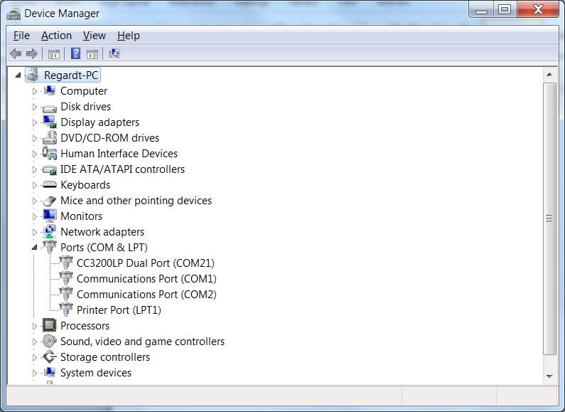

  • Hi Shlomi,
    The Daul port device is shown as com21, see screenshot below
    With SOP2 shorted, the following is provided in the log

    The COM port looks OK. Please make sure no terminal emulation or other program is occupying the COM port. This message indicates either of the followings:

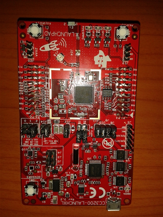

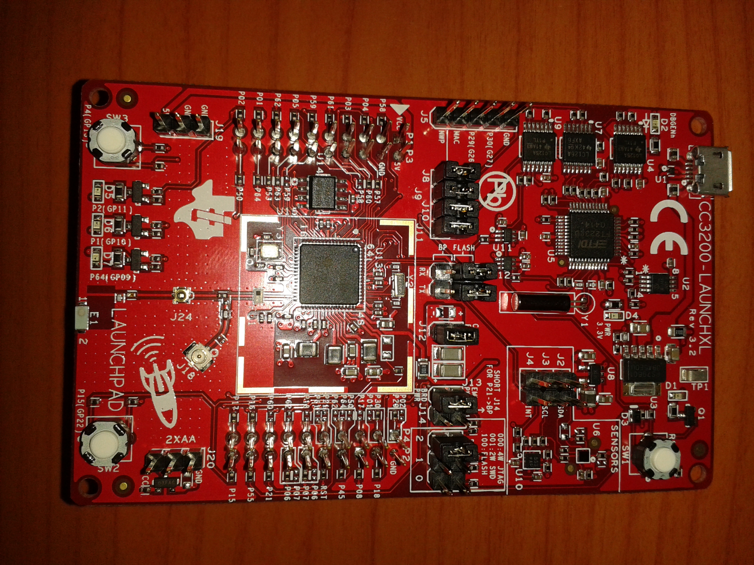

    Can you tell what CC3200 launch pad you are using? the revision should appear on silk label.
    Also, it might be that the jumper settings is incorrect. Can you send me a picture of your board settings?
    Regards, Shlomi
    I double checked the com-port (21) and if I select a different one it never gets this far.
     Therefore it does look like I am connecting to the comport.
    The board rev is 3.2.
    I have attached i photo of the PCB.
  • Well, it looks OK.
    I thought that the J6-J7 that are not populated correctly as these jumpers define where the FTDI UART lines are connected to (in your case it is directed to CC3200 chipset).
    The jumpers setting is working fine on my setup so this is not the issue.
    The only thing that remains is to probe the UART lines. I do not see any other option.
