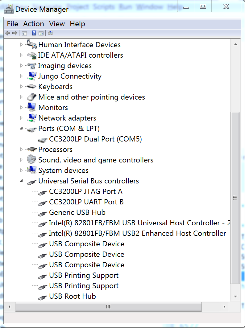

  • For the basic setup:
    Picture of board:
    Screeshot of device manager:
    No other device is using the COM port. I have tried doing a full reboot and ensuring Uniflash is the only open application.
    This is on Windows 7 SP1 x64

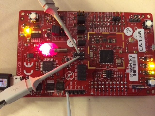

    With a logic analyzer attached as shown, both pins are always logic high, regardless of the state of the reset switch.
    Also, when powered, the green and orange LEDs on the CC3200 (GPIO 10 and 11) are illuminated, as well as the power LED (D4) and the RESET LED (D1).
  • The setup looks fine but the test I requested indicates that the TX line from CC3200 is not going LOW when reset is pressed and hold. Also, since the FTDI is disconnected from CC3200, I would expect to have the RX LOW all the time.
    Just to make sure, when you reset the board, does D1 goes off and then on?
    Shlomi
  • Yes, pushing the reset button does toggle D1.

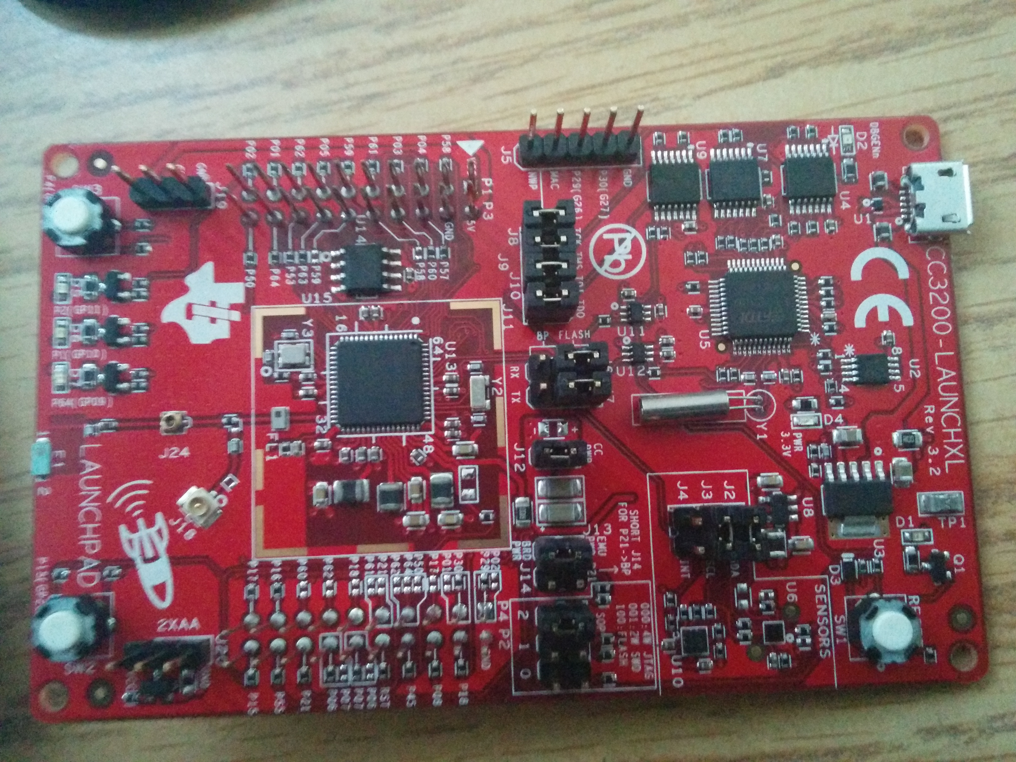

  • Shlomi,
    Everything was working one day, and one day after I got this error on CCS, so I went investigate the problem. Follow the picture you request.
