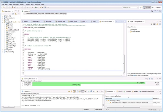

Hi all,
Can anybody help me with the following error:
"../cc3200v1p32.cmd", line 74: error #10099-D: program will not fit into available memory.  placement with alignment fails for section ".const" size 0x2672 .  Available memory ranges:
   SRAM_CODE    size: 0x12fff      unused: 0x667        max hole: 0x667
How can I fix it? Thank you very much!!
Sergey Mihaylov
  • Hi Sergei,
    As per log code section size is 75KB and free space availabe is 1639B. Whereas you need  9KB of free space in code section. So please modified code section size in linker configuration file (cc3200v1p32.cmd) as per your requirement.
    Aashish
  • Thank you very much abut your help Aashish :)!
    Do you know is there any limit of the parameters in this .cmd file?
    The origin values of parameters are:
    #define RAM_BASE 0x20004000
        SRAM_CODE (RWX) : origin = 0x20004000, length = 0x12FFF
        SRAM_DATA (RWX) : origin = 0x20017000, length = 0x19000
    I modified the second one to :
        SRAM_CODE (RWX) : origin = 0x20004000, length = 0x14FFF
        SRAM_DATA (RWX) : origin = 0x20019000, length = 0x19000
    and compilation pass. The question is related to the values, how and how much can change(or increase) this values? Are there any limits of them?
    Sergey Mihaylov.

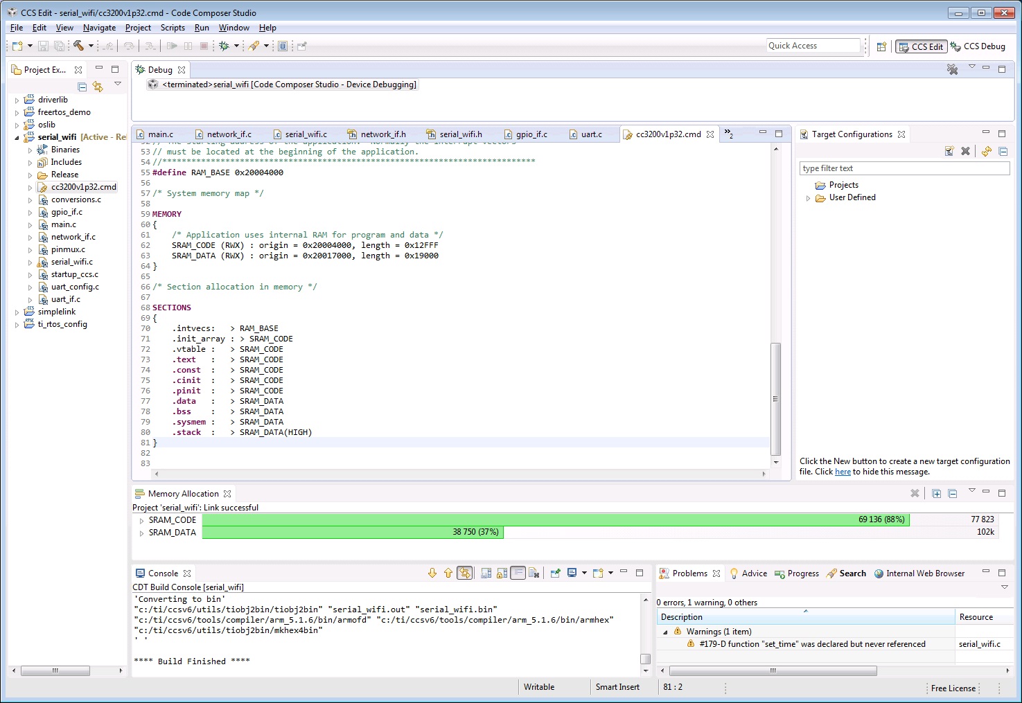

  • Hi Aashish,
    I found another solution of the issue. Create a copy of serial_wifi, and I attached my functions to it. Of course some of the existing functions I delete them (to free memory location space). Now compilation pass, and my functions seem work. Here are and the results:
    Is it the post that ask me to make or not? Sorry about this question. The modification which I was made, in .cmd file was as I described above:
      SRAM_CODE (RWX) : origin = 0x20004000, length = 0x12FFF change to ->
    and
    SRAM_DATA (RWX) : origin = 0x20017000, length = 0x19000 change to ->
    SRAM_DATA (RWX) : origin = 0x20019000, length = 0x19000 nothing else.
    The compilation in that case pass, but my functions didn't work. Now my compilation pass and functions work. But as you can see, I haven't modified .cmd file. With simple words I try to enter in the default memory space (as it set in .cmd file without change it). In that case I delete existing functions in serial_wifi project, and put my functions on their place.

  • Hi Sergey,
    and
    Here is problem in your configuration. You increase SRAM_CODE from 0x12FFF to 0x14FFF means by 8KB so now you have to reduce SRAM_DATA size from 0x19000 to 0x17000.
    So here is right configuration:
    SRAM_DATA (RWX) : origin = 0x20019000, length = 0x17000
