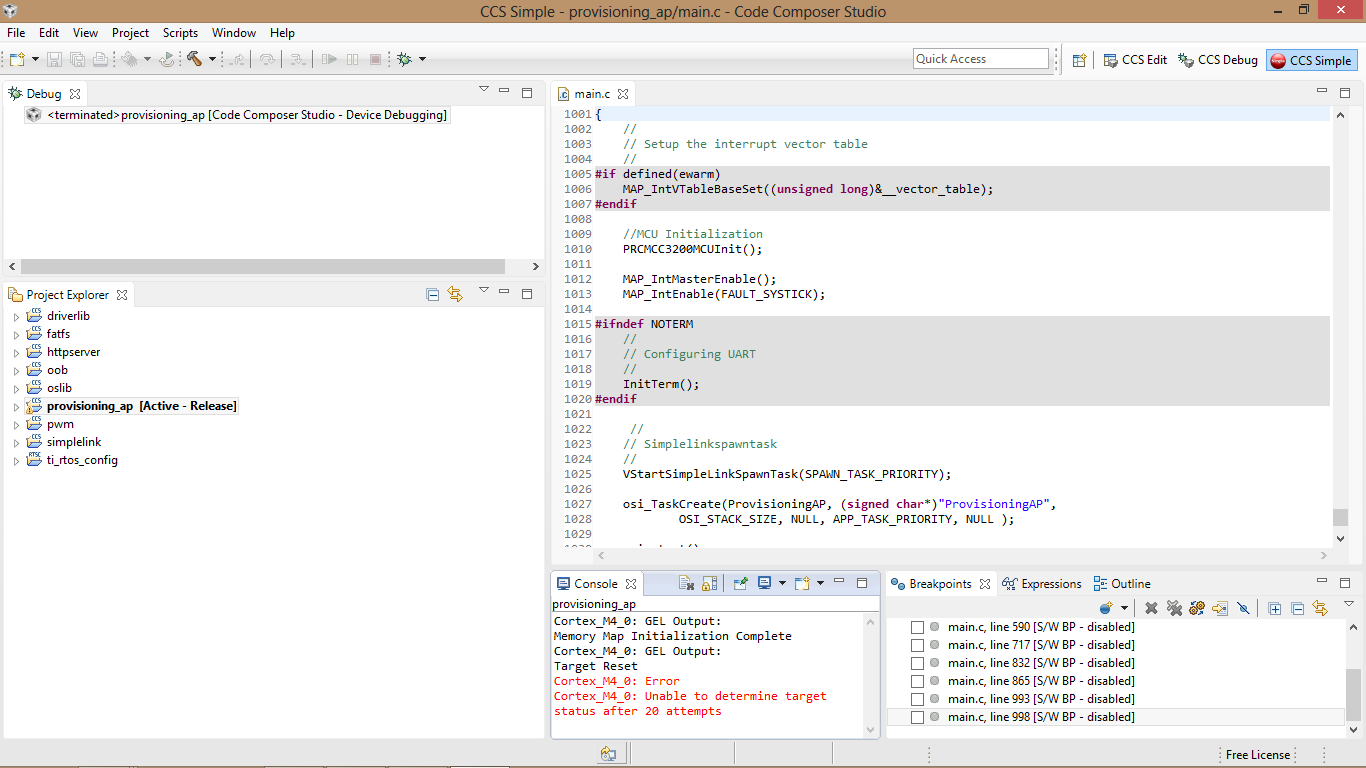

  • Dear Victor,
    I have a problem when I reached the final steps in AP-Provisioning.It gave me a message that I am successfully connected to my home AP but when I open (mysimplelink.net/main.html ) and after that to deviceconfig in order to change from access mode to station mode and then press reset it doesn't work and it is stuck there and I receive this message in the CCS debugger as you see
  • Hi Haitham,
    You reset the device while CCS is debugging. The will certainly drop communication with the PC.
    I'd suggest you get some more familiarity with embedded programming before proceeding further. It is crucial for you to understand what goes behind the scene.

  • Hi Haitham,
    Please follow the instruction carefully. It says you need to use Uniflash to flash the files onto the device and bring up the demo. Debugging in CCS will not work because application code is downloaded into RAM only under debugging. Once the reset is pressed, the RAM is cleared.
