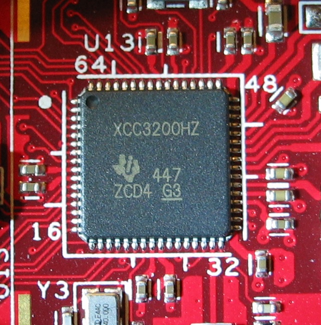

    Can you please post here the version printed on the device. It would be something like this "CC3200??"
    Thanks and Regards,
    Praveen
  • Hi Praveen,
    It is XCC3200HZ. Let me know if you need any of the other information printed on the package.
    Steve
  • Hi Steve,
    It is a pre-production part. The ROM APIs are only supported on production part CC3200R1.

  • Hi Steve,
      Would you send either a description, or a picture, of the Revision information on the CC3200 LaunchPad you are having difficulties with, please.  Also, there are revision notes on the CC3200 WIKi, as well as a lot of other information, not sure if you have explored this?: http://processors.wiki.ti.com/index.php/CC31xx_&_CC32xx .
      (FYI, I support Andrew and his team, even though I am located in Dallas, so that is what prompted me to contact you.)
    ~Leonard

  • Hi Steve,
      We can either send you a CC3200 for replacement on the EVM, if you have the ability to rework this pcb.  Or we will have to arrange for an exchange of the EVM.
    Let me know your preference.
    ~Leonard
  • Hi Leonard,
    Technically I do have the tools to re-work the PCB but realistically I don't see that going well - would probably go from a' sort-of' working board to a 'not-working' board ;) Therefore the option for a new LaunchPad board would be my preference.
    Thank you,
    Steve
