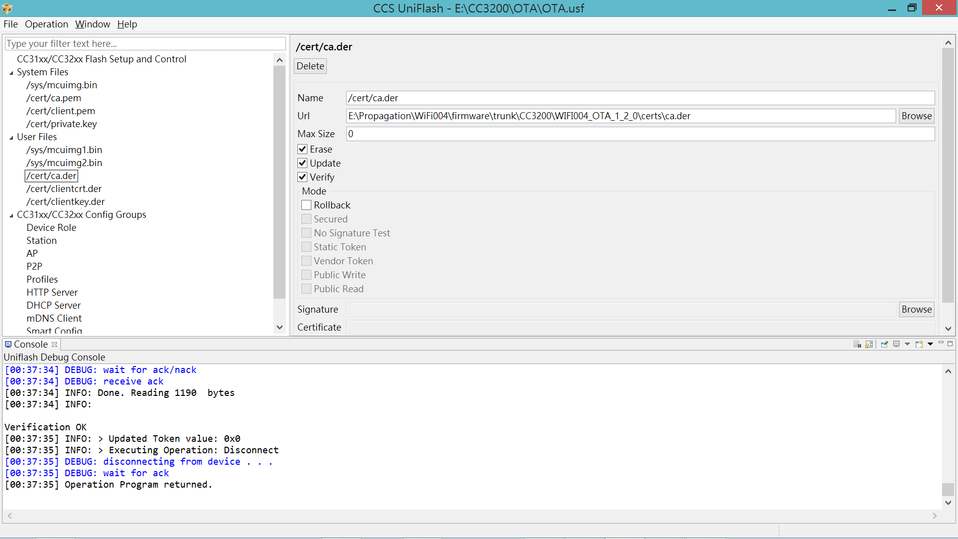

I am trying the MQTT client with security option, but never got it working. does anyone who got it success?
  • my configure of usr_connect_config just like following
    char *security_file_list[] = {NULL, NULL, "/cert/mosquitto.org.crt", NULL};
    /* connection configuration */
    connect_config usr_connect_config[] =
    SL_MQTT_NETCONN_SEC,
    SERVER_ADDRESS,
    PORT_NUMBER,
    4,
    SL_SO_SEC_METHOD_SSLV3,//checking it out in socket.h
    SL_SEC_MASK_SSL_RSA_WITH_RC4_128_SHA,//checking it out in socket.h line 314
    security_file_list
    SERVER_MODE,
    true,
    NULL,
    "user1",
    NULL,
    NULL,
    true,
    KEEP_ALIVE_TIMER,
    {Mqtt_Recv, sl_MqttEvt, sl_MqttDisconnect},
    TOPIC_COUNT,
    {TOPIC1, TOPIC2, TOPIC3},
    {QOS2, QOS2, QOS2},
    {WILL_TOPIC,WILL_MSG,WILL_QOS,WILL_RETAIN},
    false
    the /mosquitto.org.crt file i got it from http://test.mosquitto.org/, and

  • Thank you for directing me to that post.  I dont know if the SSL Demo app will help me since it seems to use different functions to connect to a SSL server VS the MQTT libraries?  Either way, the original poster had some hints in the code he posted that pointed to where I can specify SSL cipher and methods in the connection configuration like this:

    In uniflash:
    Is there anything wrong?
    Thank you very much.

    After set it up, I start to generate SSL/TSL part.
    To generate ca cert and server cert,
    I use bash ./generate-CA.sh (AND it is changed to -sha256)
    and to generate client cert,
    I use following command:
    openssl genrsa -out client.key 2048
    openssl req -new -sha256 -out client.csr -key client.key -subj "/CN=client/O=example.com"
    openssl x509 -req -sha256 -in client.csr -CA ca.crt -CAkey ca.key -CAserial ./ca.srl -out client.crt -days 3650 -addtrust clientAuth
    And then, copy them to mosquito folders and change the mosquito.conf
    As you said, I use the file extracted from mosquitto.conf.gz
    and change the port to 8883, change the ca path and require_certificate to true.
    And after that, I use sudo service mosquitto restart to restart mosquitto.
    Then I change those cert file to .der file.
    For .crt file, I use openssl x509 -in certificate.crt -out certificate.der -outform der
    For .key file I use openssl rsa -in client.key -outform DER -out clientkey.der
    Then the server is set.
    I tried to use those file with mqtt.fx and it works fine.
    So I flash them to CC3200 and modify the sample mqtt project.
    But dun know why it cannot connect to broker.
    I also tried do not use client file.
    I am using the same router with CC3200
    and I think the IPLIST is okay as I can use same IP with MQTT.fx.
    Best Regards.
    Bryan

    5. upload der versions of CA certificate and client certificate and key to CC3200 with uniflash

    4.  Programmed the DST Root CA X3 certificate (in .der format)) into /cert/dst.cer using uniflash
