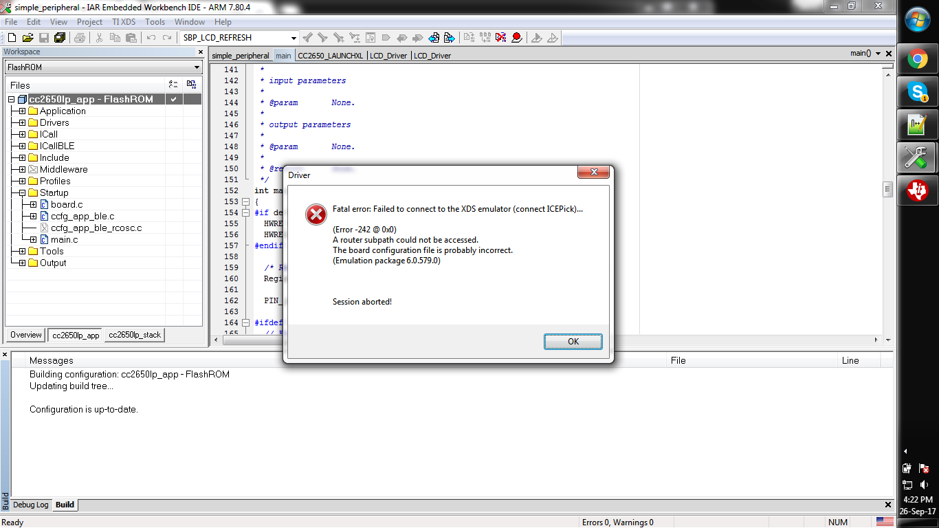

I want to use XDS110 downloading only using 2-pin cJTAG, but failing. Could you tell me the reason ? thanks.
smart RF Flash Programmer 2 ver.1.7.4
It actually does support 2-pin cJTAG, but you will need to tweak a file in the installation (we haven't enabled a GUI option to select this, unfortunately). Here's what you need to do:

I am looking to do the same thing. Use the XDS110 on a custom 2640 board using a 6 pin cjtag. Can it be done?
Not sure what you mean by 6 pin cJTAG, but it should work in the same way for any XDS110.
With the XDS110? Or is a different debugger required? I am using SmartF Flash Programmer 2 ver 1.7.4 to flash. What changes need to be made during the build and flash process to allow for cjtag?
have you try to download the lastest revision of Smartrfprogrammer v1.7.5
I have a problem with v1.7.4 and no problem with v1.7.5
