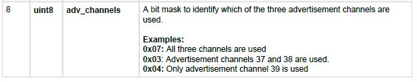

I have a cc2540EMK-USB dongle, and I installed Wireshark 2.4.7 and SmartRF Packet Sniffer 2.18.0.
I chose the correct advertising channel of my BLE device, although I only see the advertising packets which do not have initiator address when I connect two devices (a mobile and BLE device). For this reason, I can not configure "Connect to initiator address" in "Radio Configuration" tag, and as a result, I see no data packets.
The BLE project does nott use encryption.
Has anyone managed to make this work?
