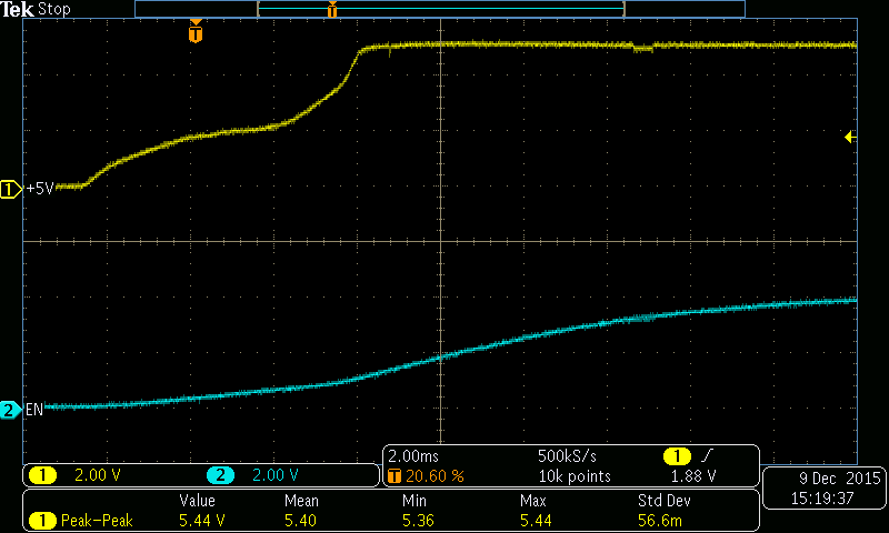

    You have me concerned about how we're handling the EN line. From what I heard you say, the EN line needs to experience a low-to-high transition while the device is powered up in order to function properly. Is that correct? Again, we have EN2 tied low. That would explain the capacitor, C28, that is connected to the EN line. It must be there in order to provide this rising edge. I captured the voltage on the EN line as well as the Vcc (=5V) to the board. I've attached the resulting scope plot. I  think the labels explain which signal is which. I don't see timing information for the EN signal in the data sheet in terms of the rise time or the amount of time Vcc needs to be stable before EN comes up, so maybe I can get your opinion on this measurement result please.
     th
  • Josh,
    Have you had a chance to review this scope plot? I am very interested in the timing requirements for the EN signal on power up. Thank you.

    regarding your plot - looks like EN is not controlled (looks like it is floating up) and very slow. i would ask you to please look at this and check that you follow section 3

    You are correct, we do not control the EN line. Please refer to the schematic I sent you. You'll find that the EN line is NOT under the control of a Microcontroller. Instead, this line is brought up slowly by placing a cap on it. Is there anyway to modify this design so that another control signal from the input connector is not required? I referred section 3 of the document you referred me to and I see what is required. However, can you provide timing information in terms of how long the power supply has to be up and stable for this to work?
  • if you change R2 to 100 ohms and R9 to 10k, you will reduce your rise time from ~44mSec to about 1mSec, plus get above 4V (what you are limiting yourself to now. (would go up to 4.9VDC or so i think, no big deal, i think the faster rise is better here for you)

  •  Josh, Okay, this is what I get. The Enable line tracks the power supply as it comes up. Is this really what we want? The flow chart in SLOA168 Section 3 indicates the power should come up first and then the EN signal. That was the idea behind the slow rise time.

    The EN line is best controlled  by MCU. This is the recommendation. Otherwise,  the RC is about the best mitigation you have in your case.

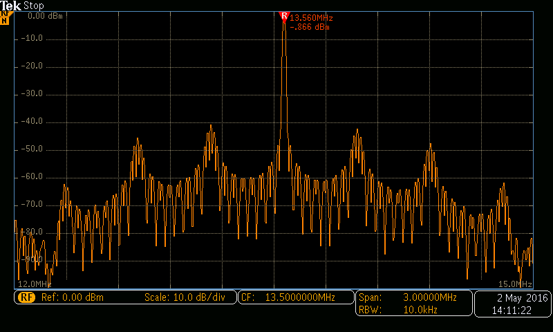

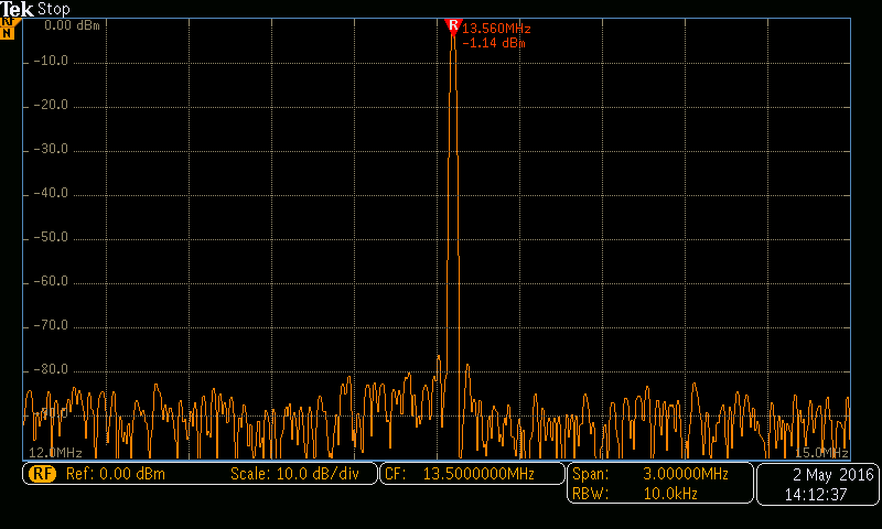

    I still don't have a good handle on this problem. We have PCBs that work well and others that do not seem to be able to read the RFID tag reliably and I do not know why. What would you recommend I measure to find out how these two sets of PCBs differ?
    I did examine the field strength between the passing and failing RFID PCBs and they were essentially the same. Would going from a Q = 7 like I have now to a Q = 16 be expected to improve this problem?
    I also captured the spectrum of the communication between the RFID PCB and the tag. I found three flavors:
    Some of these spectra seem too broadband for a Q = 16 to be used. Do you think going to a Q = 16 is worth a try?
