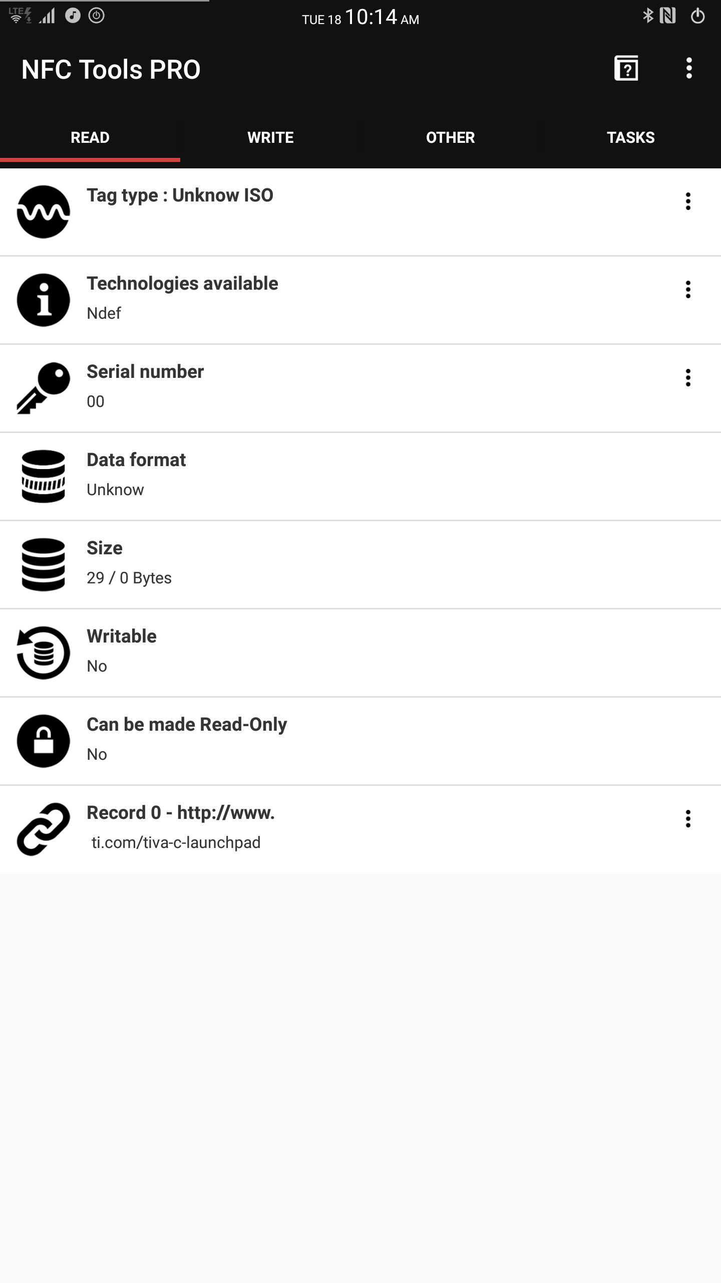

  • Samsung Note 5 (N920T) using the NFC Tools Pro app. For testing the part of the demo that sends the TI URL I keep the app in the read view, then press the button on the launchpad to fire the URL. The app will show the URL in one of the fields from the read.
    Here is a screenshot of the app when I press the SW1 button on the launchpad (and hold my phone over the launchpad):
  • Hello Tanner,
    The app you downloaded is only designed to write to NFC tags which is a different method of NFC communication than Peer to Peer.
    It seems the app I've been using for years isn't on the Play Store anymore, but I would check out apps which say they can support "P2P" data sends. It looks like Legic has such an app, and also there is an "NDEF Tools for Android" which supposedly can beam P2P data. I would check those out.
