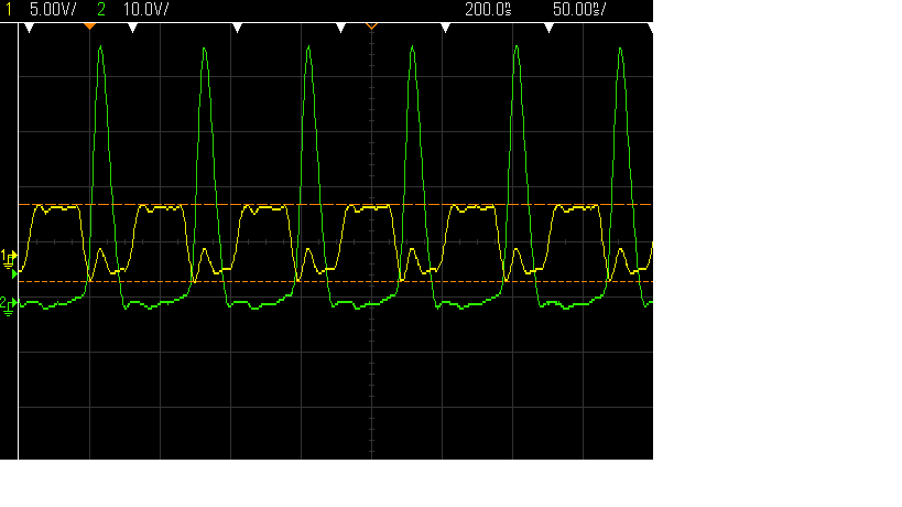

    I have gotten this board, it is a little different from your circuit.
    L101/L104         538nH (replacing 560nH in your circuit)
    L105                  422nH (replacing 390nH  in your circuit)
    Vgs(channel 1: Vpp=7V ) and Vds(channel 2:Vpp=47.8V) waveform is shown, less duty ratio and high peak-peak value comparing to fig 9 in the document
    TP03 Signal (Vpp=19.7V) at 50ohm after impedance matching network(L101/C101/C102/C103) is shown, it is a good sine wave.
    Are they correct signals waveform? How should I adjust these component values if not?

    3.
    I have gotten this board (made according to your simulation circuit), it is a little different from your circuit.
