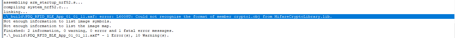

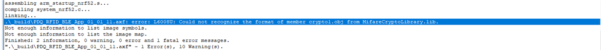

    Can we use MifareCryptoLibrary.lib in our code? given in Mifare Classic read example or it built for MSP430F2370 only.
    Getting error when compile with Keil "Could not recognize the format of member crypto1.obj from MifareCryptoLibrary.lib."

  • Hello Nirav,
    The .lib has to be compiled based on the target MCU core, so it is not possible for it to be used with third party MCU's. For other TI MCU's, we recompile the library and provide it for specific target MCUs, but it will not be possible for us to do that for third party MCU's.

  • Hello Nirav,
    I need to follow-up on my prior comment regarding the .lib, you can actually use the source files from the Direct Mode 0 example with the SDM example to be able to leverage SDM on non-TI MCUs. It's just that library we built for SDM mode allows access without making the request through the Secure Software site. Sorry for my prior comments before that incorrectly stated it wasn't possible.
