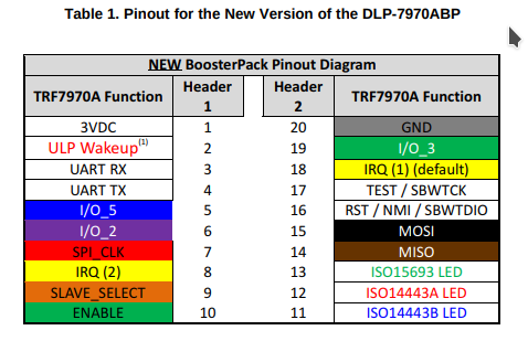

The following are the the pinouts for the SBC and DLP7970ABP board I'm using:
Apart from the obvious ones, I have connected:
SBC pin 5 (SS0) to pin 9 (Slave Select) of the TI board
SBC pin 6 (SS1) to pin 10 (Enable)
SBC pin 7 (SPI_IRQ) to pin 18 (IRQ (1) default)

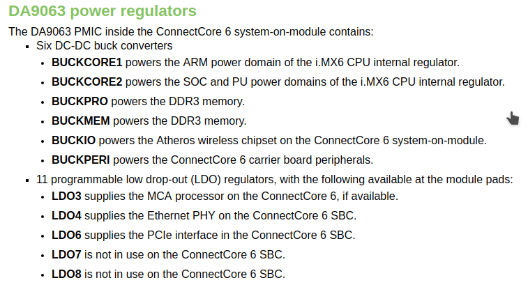

    - Have you set up the necessary regulator(s) in the DTS file (see vdd-io)? It appear that you haven't according to the message above. Be sure the chip has power.
    Hi Mark, thanks for your answer. The following regulators are defined in the imx6qdl-ccimx6.dtsi file:
    I used BUCKPERI for vin, I wouldn't know what to use for vdd-io-supply. Do I need to include vdd-io-supply in the parameters?

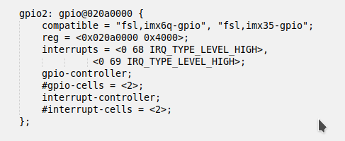

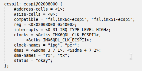

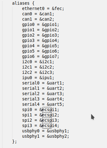

    OK so the trf7970a node definition and pin configuration that I sent in the OP are both from the imx6qdl-ccimx6sbc.dtsi file (is this ok?), the following are ecspi1, gpio2 (that I use as interrupt parent) and aliases defined in imx6qdl.dtsi:
    Do you want to see more?
