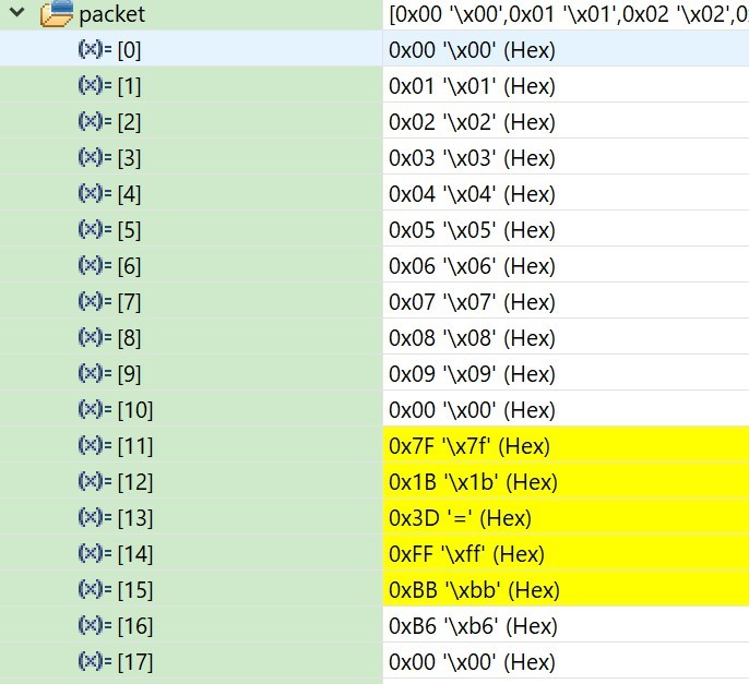

My customer is using 2.4GHz proprietary mode in their application. Fixed length mode(pktConf.bVarLen = 1) is used to compatible with legacy devices. And customer wants to get RSSI value of each received packet.
When the packet length fields in TX and RX side are set to the same value, RF_cmdPropTx.pktLen = 10 and RF_cmdPropRx.maxPktLen = 10, the valid RSSI value is appended into the 11th byte(packet[10]=0xE5) of rx buffer.
In customer's application, two types of packet with different length are sent by the TX side, and fixed length mode should be used to compatible with legacy devices. So packet length fields in TX and RX side are set to different value, RF_cmdPropTx.pktLen = 10 and RF_cmdPropRx.maxPktLen = 16. Then, the payload can be received correctly, but the appended RSSI(the 17th byte in rx buffer, packet[16]=0xB6) seems invalid.
This issue can be reproduces based on example project rfPacketRx/rfPacketTx, attached are .c files I used in reproducing the issue.
I also did the same test with CC1310 launchpads, the appended RSSI is valid in both conditions(with same or different value in length field in TX and RX side).
In the TRM document, it says that "If pktConf.bVarLen is 0, the length is fixed, and the receiver assumes maxPktLen bytes after the sync word and before the CRC". So, it should work correctly even the TX and RX sides use different length value with fixed length mode.
Please help to answer below questions:
1. how to get valid appended RSSI in fixed length mode, while length field is different in TX and RX side?
2. if it is not possible to get valid RSSI appended, what the work around?
3. why CC26xx has this issue, while CC13xx does not?

    The RF settings are all the same in above test, the only difference is the RF_cmdPropRx.maxPktLen in RX side. The same launchpads are used in the test and also the launchpads keep in the same position during the test. So the RSSI should be the same, no matter RF_cmdPropRx.maxPktLen = 16 or RF_cmdPropRx.maxPktLen = 10.
    The TX side keeps sending packets with 10 bytes payload.
    When set RF_cmdPropRx.maxPktLen = 10, the RSSI is 0xE5(-27dbm).
    When set RF_cmdPropRx.maxPktLen = 16, the RSSI is 0xB6(-74dbm).
    Why the RSSI values differ so much?
    I also monitor the RSSI in the output structure, it has the save value with packet[RF_cmdPropRx.maxPktLen].
  • Hi, Siri,
    In above test, the TX power is 5dbm, which is the default setting in rfPacketTx example.
    Then I set the TX power to 0dbm by setting .txPower = 0x3161, and monitor the RSSI value in the RX side,
    When set RF_cmdPropRx.maxPktLen = 10, the RSSI is 0xE9(-23dbm).
    The RSSI remains 0xB6 while the TX is 0dbm and 5dbm. That's why I think this value is not valid.

  • Hi, Siri,
    I have done the test as you recommended, and get below result.
    1. When RF_cmdPropTx.pktLen is equal or longer than RF_cmdPropRx.maxPktLen, the appended RSSI value is around -29dbm. And I think it is reasonable.
    2. When RF_cmdPropTx.pktLen is shorter than RF_cmdPropRx.maxPktLen, the appended RSSI value is fixed 0xB6.
    In all the test, the appended RSSI has the same value with RSSI in the output structure.
    Attached is the RF setting used in the tests.

  • Hi
    I will do some testing when I am back in the office tomorrow, but in the mean time, can you try to add the following override:
    HW_REG_OVERRIDE(0x6084, 0x35F1)
    Add it right before the (uint32_t)0xFFFFFFFF, override. This should make sure that the RSSI is not beeing updated after sync is found.
    BR
    Siri
  • I have now done some testing. Use the override HW_REG_OVERRIDE(0x6084, 0x34F1), and not HW_REG_OVERRIDE(0x6084, 0x35F1), and the RSSI will freeze on Sync found.
    BR
    Siri
  • Hi, Siri,
    Thanks very much for your support.
    I can get valid RSSI with both "HW_REG_OVERRIDE(0x6084, 0x34F1)" and "HW_REG_OVERRIDE(0x6084, 0x35F1)"
    What's the different between this two override? I also checked that CC1310 settings used "HW_REG_OVERRIDE(0x6084, 0x35F1)".
  • There are 3 bits internally that is used to modify some AGC Hysteresis settings. The CC2650 uses the default setting of 4 for these bits while the CC1310 overrides this and set it to 5. The setting I first sent you was for CC1310 and CC2650. settings these bits to 5 on the CC2650 will also work, but you should use 4 as this is what we have been testing with.
    Siri
  • Hi, Siri,
    Got it, thanks for your explanation.
