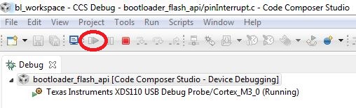

    Hi Richard,
    I ran your example and it worked well.
    Now, I would like to stored a whole page, instead of the led struct.
    I made the following changes:
    The page in SRAM. It is used during
    run-time.
    uint8_t pageInRam[FLASH_PAGE_SIZE];
    The same page in FLASH.
    It is linked automatically into the .flashdata section and initialized
    for the first use.
    #pragma DATA_SECTION(pageInFlash, ".flashdata");
    const uint8_t pageInFlash[FLASH_PAGE_SIZE];
    Then, my test is the following:
        memset(pageInRam, 0xAA, sizeof(pageInRam));
        updateMemoryInFlash((void *)pageInFlash, pageInRam, sizeof(pageInRam));
        memset(pageInRam, 0x00, sizeof(pageInRam));
        memcpy(pageInRam, pageInFlash, sizeof(pageInRam));
    These are the only changes I did in the example.
    The code compiles without any error, but I can't run the debbuger with it. The button remains "disabled".
    Can you help me?
    does your application start? Can you step-debug? At which line does the application fail?
    Does it work when you lock the interrupts before calling updateMemoryInFlash()?
    #include <ti/sysbios/knl/hal/Hwi.h>
    uint32_t previousState = Hwi_lock();
    Hwi_restore(previousState);
    It wasn't even starting.
    Anyway, I changed from:
    to:
    const uint8_t pageInFlash[FLASH_PAGE_SIZE] = { 0 };
    I am not sure why, but now it is working.
