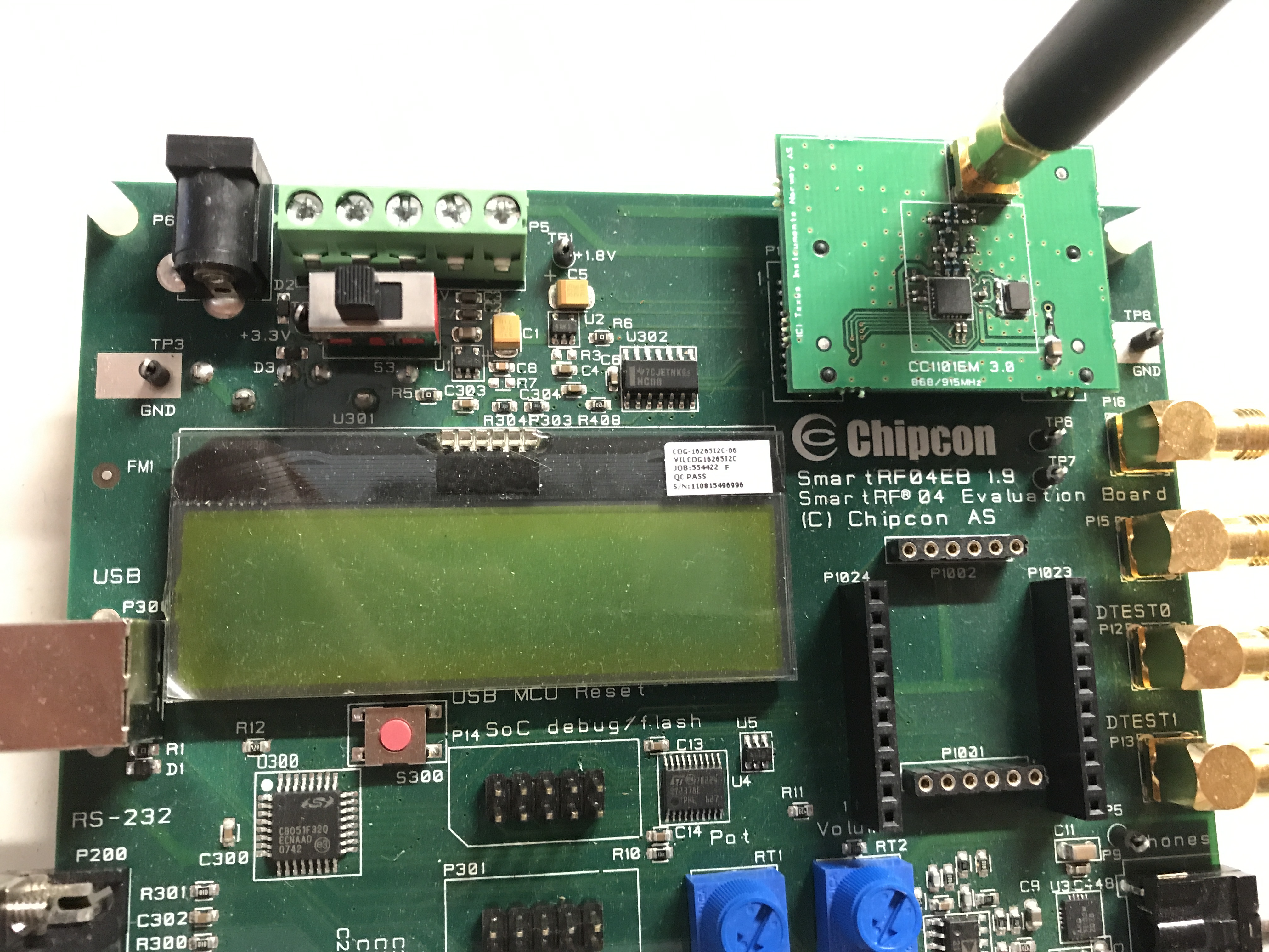

    I too am having issues working with the CC1310 and CC1101 using Smart RF 7 2.6.0 build #8. I followed the instructions and screen shots on this post and haven't been able to achieve successful communication. The only packets I've been able to receive is when the 1310 is in RX and the CC1101 is in TX. 1310 got two packets of various lengths with CRC errors. I'm using a CC1310 Launchpad Rev. 1.4 and CC1101 Eval on a smart 04EB.
  • Tim M: Please post your setup.
  • Image 1) CC1310 - TX
    Image 2) CC1101 - RX
    Image 3) CC1101 - Continual RX, CC1310 - TX, observable transmission

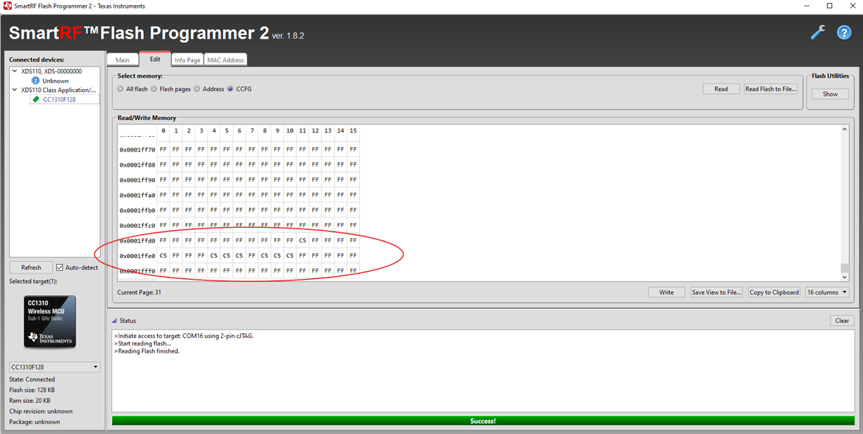

    Did a quick test with the attached settings and didn't see any issues.
    Do you have a old legacy CC1101 system using CC1101?
  • The legacy CC1101 works Rev. ID 04, I have another board with Rev. ID 14. I'm having issues with Rev. ID 14. The following is my setup. I know there are other posts on E2E regarding the rev id change and issues with SmartRF. I've previously referenced those articles when debugging my communication issues with SmartRF and the CC1101.
  • Follow up on my setup. The CC1101 Rev. ID 14 will work at 915MHz. I had to first jump back and further between continues RX and TX. Then it seemed to be able to communicate with the CC1310 both in RX and TX.
