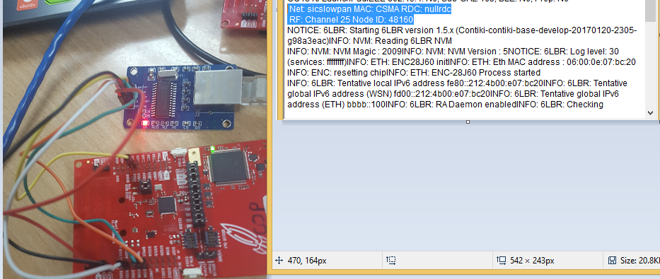

    How can I setup chanel in broadcast-example to 25? And I want to ask you why I got
    "INFO: ENC: resetting chip"
  • You can add "#define RF_CORE_CONF_CHANNEL 25" in project-conf.h of your 6lbr and broadcast-example. As for why you get "INFO: ENC: resetting chip", do you connect ENV28J60 to your LAUNCHXL-CC1310?
  •  Dear YiKai Chen,
    For 6lbr, it run in chanel 25 as image, and I use ENC28J60
  • Can you open web page [bbbb::100] from Firefox?
  • Dear YiKai Chen,
    I used Chrome and still open webpage.
  • It looks running correctly. What's your issue?
