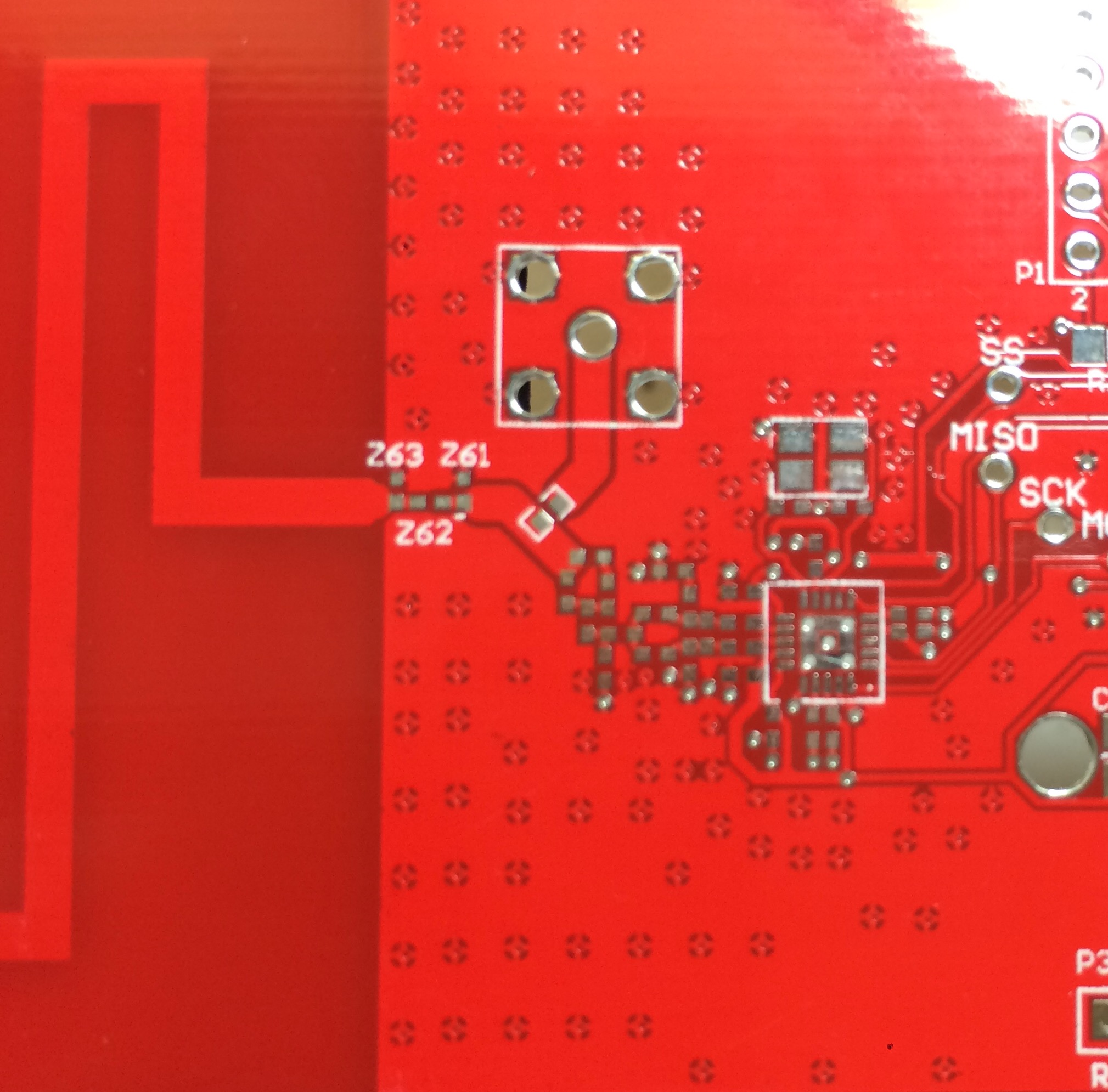

Hi. I'm using CC1101 for a simple two-way communication application.
Based on the CC1101EM reference design (SWRR045), I just added the matching components for a monopole PCB antena (Design Note DN024).
Here's the schematic:
The PCB layout is copied from the reference design, and I added the antenna with its matching components with a 50 ohm trace calculated for the 0.8mm thick PCB:
SPI communication is working, and the code works in another board which uses a separate CC1101 module (Anaren A1101R09A and another generic module).

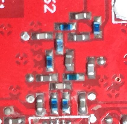

I can see a pulse/square wave-like signal coming off the RF_N and RF_P pins, which propagate until C125 (on the schematic). After that, there's no signal.
On the working module, I can also see the signal coming out of the differential RF pins and propagating through the balun and reaching the antenna.
Any clues about that?
