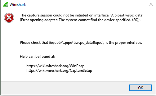

    next step is to see them in the wireshark app. I am following the manual but having problems.
    I have installed wireshark version 2.0.15 as you requested to be in old version 2.0.x. do I need to install wcap with wireshark installation ?
    I have added the  -i\\.pipe\tiwspc_data -k to the shortcut.
    when I run wireshark and try to start i get a message the "system cannot find the device specified".
    see attached file.
    please advice ?
    please advice.

  • Roy,
    You can select how you want data to be outputted by selecting Data->Data Out in the TiWsPc2 menu bar. You can change pipe setting by going to Options->Pipe Config. If you are using the packet sniffer with the SimpleLink CC13x0 SDK v1.40 then Wireshark v2.2.x is required.
  • I have tried using both wireshark version 2.0.x and 2.2.x without success.
    problem origin seems to be that even when pipe is configured it cannot be found by wireshark.
    I have downloaded a tool called "process explorer". this tool can show what pipe were created by a specific process.
    it seems the even after i have configured the pipe and clicked "start all" pipe is not created.
    can you tell what can be the reason ? can you consult with someone ? ( btw, I also tried running TiPcWs2.exe as administrator)
  • I tried that tool with no luck on viewing my working pipe. I saw Microsoft offers another tool PipeList that I used to successfully view the pipe created by TiWsPc2.
  • Hi Guys,
    Not sure if you have noted.
    There is something wrong in the guide. It should be
    " -i\\.\pipe\tiwspc_data -k ", instead of
    "-i\\.pipe\tiwspc_data –k".
    If you look carefully, there is a '\' missing.
  • Thanks Yan,
    This comment solved the issue. now I am able to see incoming messages in the wireshark.
