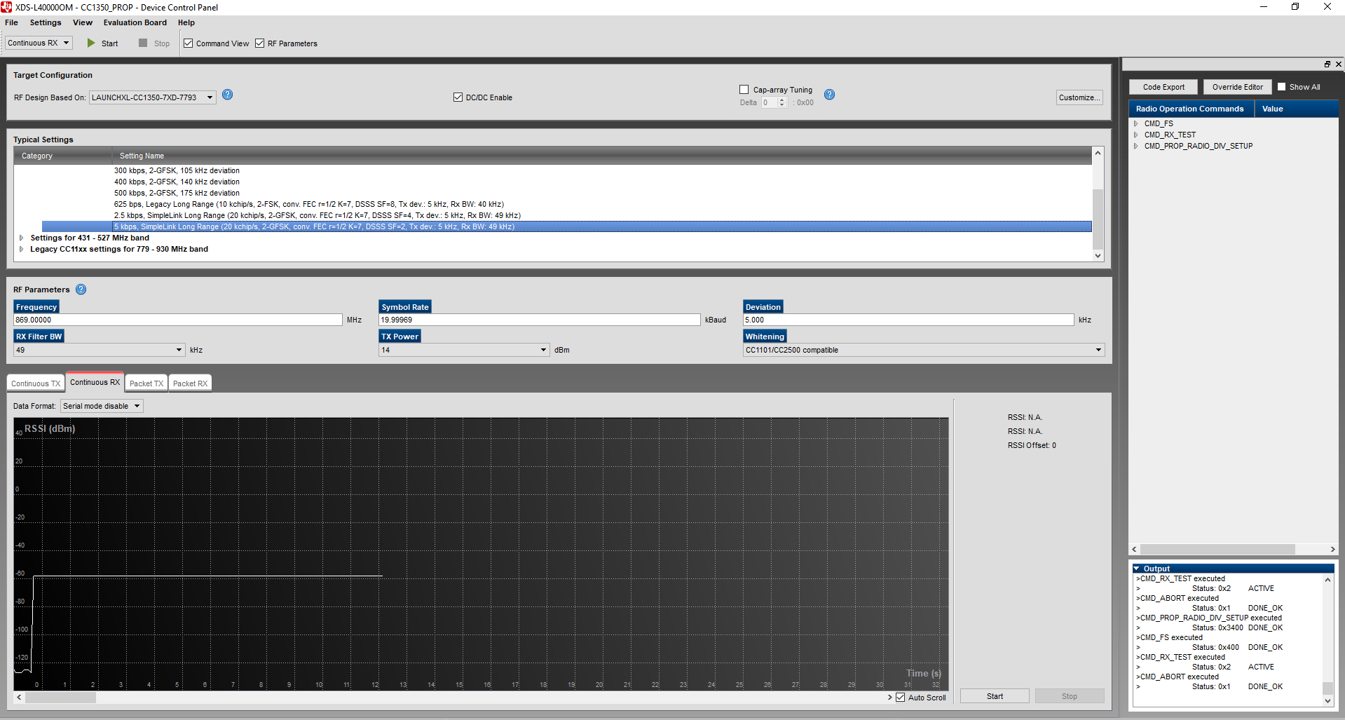

I'm trying to get RSSI values for Spectrum Sensing application. I have started the same application using Launchpad and continue on our custom board. The problem is the same with Launchpad (tested with SmartRfStudio) andour custom board with TI-RTOS.
Create the problem with these steps:
1- On lauchpad, start smartrfstudio and setup for Continoues RX
2- Start testing for RSSI values, most of the time RSSI will fixed to value and it will not corrected until reset the board.
What is the reason for that?
Best Regards
  • Are you saying SmartRF Studio is showing you the same RSSI values? Or are you saying that after closing SmartRF Studio and executing your own code, your code shows the same RSSI values?
    Can you provide the code you are using to retrieve RSSI?
    Are you using rxConf.bAppendRssi = 1; and you are pulling RSSI from packets? Or are you just poling the receiver for the current RSSI?
  • In addition: Are you in RSSI saturation when you do the measurements? (High RSSI value). Some plots would be helpful.
    we have tried both, the lauchpad with smartrfstdio (the picture) and custom board with TI-RTOs code (attached also).

    Actually, we are trying to make something like Spectrum analyzer for specisific bands. Therefore we are not seeking packages, but we are looking only the noise level in the air. we are poling the receiver for the current RSSI. I thing the receiver is not in saturation either. (see the figure, the RSS is about  -60dBm)

  • Hi TER,
    we made some tests with different settings in the RSSI catcher side. We got different results with different settings, keeping the noise generating part the same all the time. The problem is continue also. Do you have any suggestions?
    Best Regards
  • Are you testing on Rev A or rev B of CC1310?
    it is rev B
  • I did a very simple test with a CC1310 LP using a rev B chip. I selected the 5 kbps long range mode and the cont. RX tab. I then turned on a sender and move that around a bit. I get a RSSI that varies from about -120 dBm (TX off) to about -20 dBm dependent if I use an antenna on both LPs or not and the distance is varied.
    Do you see the same or do you still get the fixed at one value?
