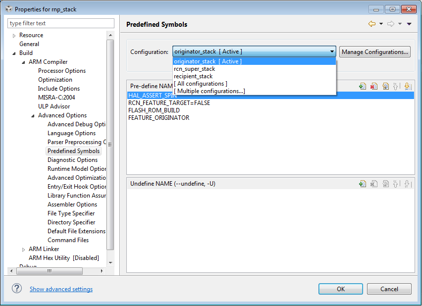

  • One more question here... Should I use the RNP sample application or the remote control sample application if I'm just trying to send data from one launchpad to the other? Also, how do select one as the originator and one as the recipient using code composer studio? Thanks again
    All projects are divided in two images; App and Stack. In case of the RNP the App is really only a serial translation layer. It converts APIs call to the Stack to serial remote procedure calls over NPI (Network Processor Interface).
    You select what features to support by selecting configuration in the Stack.
    I believe I mentioned it earlier that we'd like to try a single-chip solution with peer-to-peer communication. LaunchPad to LaunchPad for RemoTI. If I were to start that project I would take the CC2650RC project for the Originator. Then I would strip out all externals, including the keyscanner. I would replace that with a basic RTOS button driver, which you can find in the basic RTOS examples.
    For the Recipient I guess the same approach would apply, but in this case there's no Stack configuration for Recipient. In order to make one you'd have to define FEATURE_RECIPIENT, instead of FEATURE_ORIGINATOR. You'll find these symbols here:
