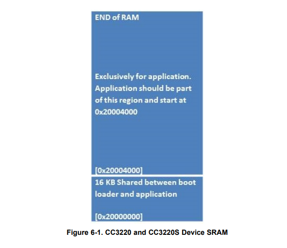

in swru464.pdf page 49 Figure 6-1. CC3220 and CC3220S Device SRAM
Exclusively for application. application should be  part of this region and start at 0x20004000. exclude the application, what else in 0x20004000 to END of RAM? Is there any more detail map of these RAM?
The amount of RAM used by the bootloader is 16KB, which implies that for the CC3220S and CC3220 variants, but in my code(I'm using CC3220S) there are 20 749 bytes of readwrite data memory is bigger than 16KB, other RAM is in the range of 0x20004000 to END of RAM?
87 530 bytes of readonly code memory
26 783 bytes of readonly data memory
  • Hi user4774248,
    I'm not sure where you're getting those numbers for code/data memory. The CC3220 has unified code/data memory, and other than the requirement that your application has to start at 0x20004000, you can put anything else you want in RAM in any order you wish. Thus, there is no detailed map of RAM; the contents and layout of RAM is up to your application.
    Of course, the linker will typically handle the allocation of RAM. If you look at the CC3220S_LAUNCHXL_TIRTOS.cmd file, there is some config for the linker there. As the CC3220S does not have internal flash, the .cmd file is very simple as everything needs to be put in RAM.
    You can also look at the linker file output in the /debug folder of your project once it is built (the .map file) to see how the linker arranged all of your application's code and data in RAM.
    Michael

  • Hi user4774248,
    Well, I suspect what is happening is that your sl_FsRead() call is overwriting the code your device is currently running, since the bootloader on the CC3220 starts execution of your program at 0x20004000.
    What you can try doing is setting aside a section of RAM that will be used exclusively for your loaded code. If you look in your CC3220S_LAUNCHXL_TIRTOS.cmd file, you will notice that your memory is split into a SRAM0 section and a SRAM section. Right below that is a set of section allocations to tell the linker to put all of the code, data, etc into SRAM and not touch the SRAM0 section (which is the bootloader section). Similarly, you can declare your own memory region in RAM and then not assign any sections to it, which allows you to reserve a section of RAM for the code you want to load. Something like this:
    MEMORY
        SRAM0 (RWX) : origin = 0x20000000, length = 0x4000
        SRAM  (RWX) : origin = 0x20004000, length = 0x1E000
        SRAM_R (RWX) : origin = 0x20022000, length = 0x1E000
    Try doing that and then doing your sl_FsRead() into the base address of your reserved RAM.
