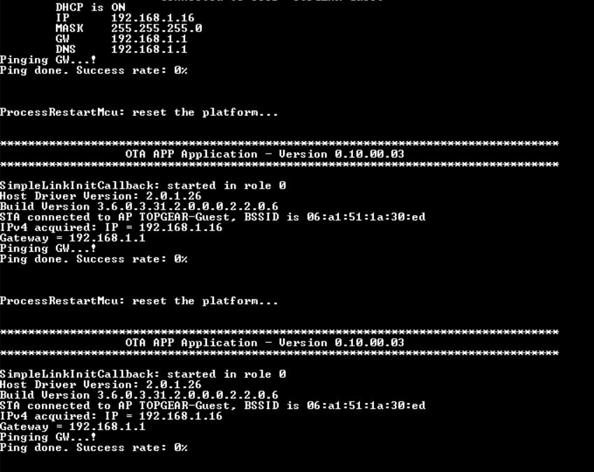

  • Hi Sarah,
    Thank you for advice and guidance. I was able to compile the Cloud OTA example. It seems to progress up to pinging step and stop there. The connection to AP is successful, however pinging GW results 0% success rate. Could you kindly advise here?
    David
  • Hi David,
    Can you print out the error code from sl_NetAppPing()? What kind of AP are you using?
    Sarah

  • Hi David,
    Are you able to ping your router from another device in network (your computer, etc.) connected by WiFi? It seems that you have deactivated ICMP echo (ping) on your router.
    Jan
  • Hi Jan,
    You are right, I was testing on a guest network that didn't have "Allow guest to access My Local Network" enabled. After enabling, the ping went through. Thank you!
